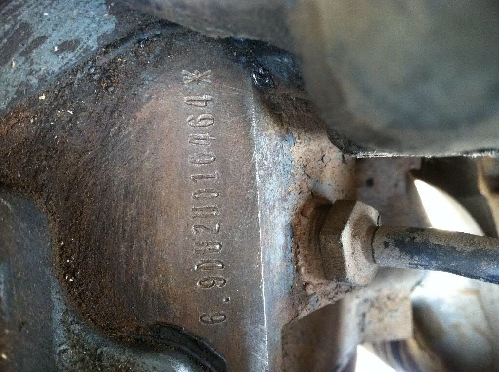

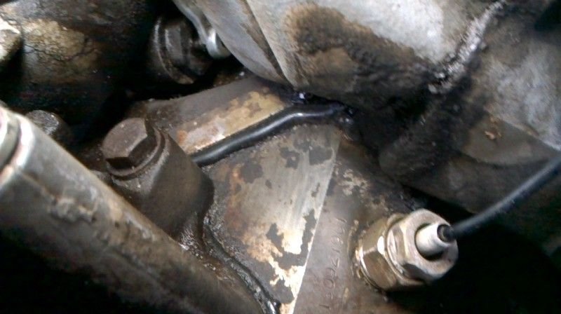

I'm not sure exactly what I'm looking at in the picture, but I think your block has had machine work done to it. The serial number should be on the flat upper face next to the IP gear housing (yours appears to be missing/milled off) it should look like this:
Some rebuilders attach a new tag with the sn or other rebuilder information.

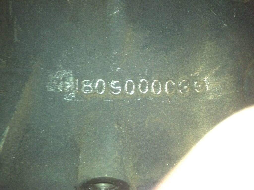

The actual block casting number is very hard to see on an engine that is still in the truck. It is kind of behind the oil cooler tube down by the motor mount bosses. This is a 93/94 7.3T "C3" block but you can see how it looks. I scraped the raised numbers so it would show up in the photograph:

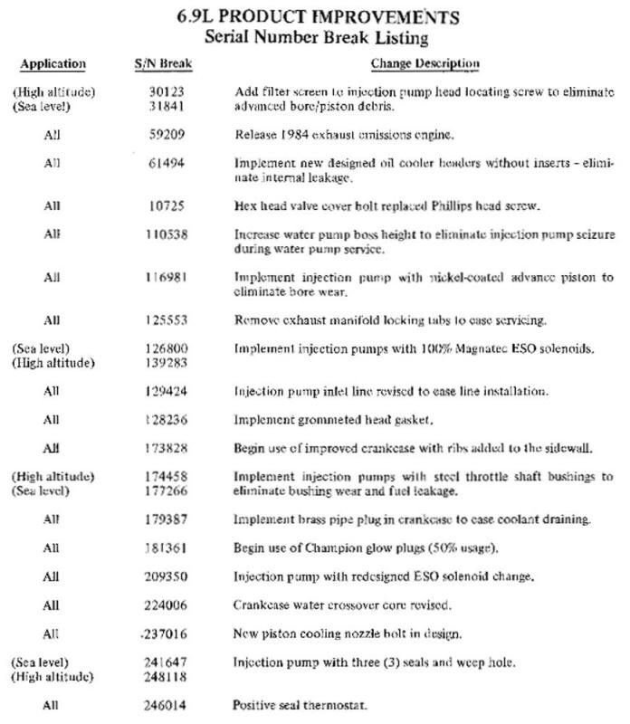

Unfortunately in the case of the 6.9 the block casting number does not actually correspond to changes in the block design. You get more information from the sn. Since that is lacking, you may be stuck with visual inspection of the casting features:

Since your block appears to have machine work done to it, keep in mind there is a good chance it is not the same year as your truck if it is remanufactured.
