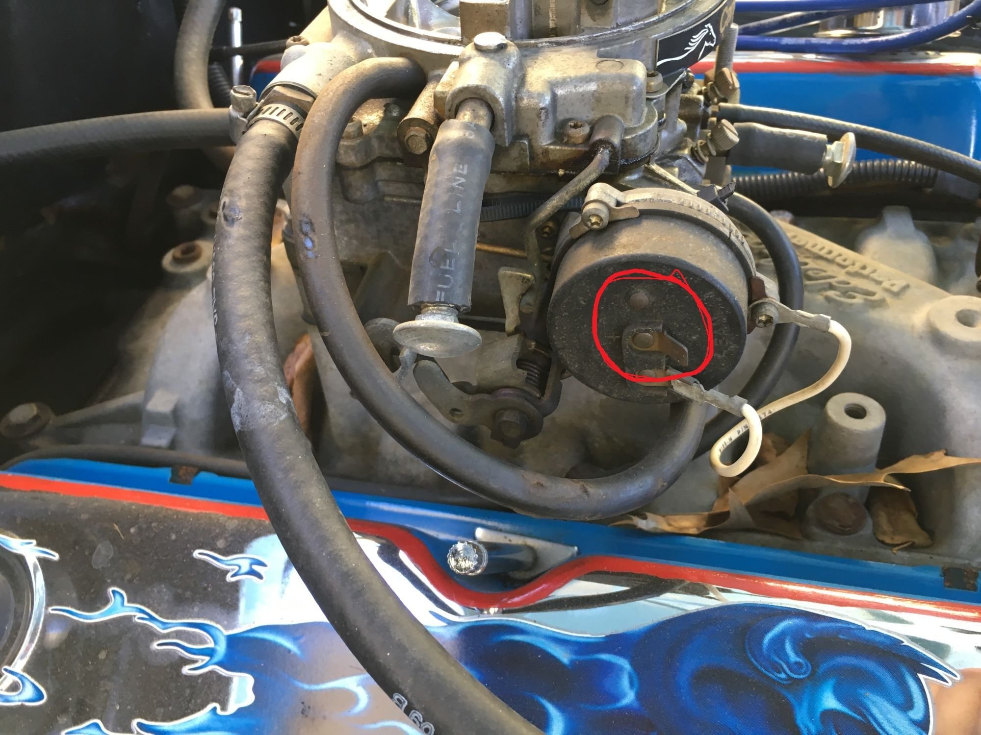

Originally Posted by Brian1971f100
Electric choke not hooked up. When cold can be hard to start and poor performance when cold.
How did he bypass not hooking up the electric choke If i dot not have to pull the choke to crank?
Old Jan 27, 2017 | 01:26 PM
Brian1971f100's Avatar
Brian1971f100
Joined: Mar 2016
Posts: 1,412
From: Barre Mass
The electric choke requires power. I'd have to research what voltage the Carter AFB needs. If 12V then power it off the "s" terminal on your starter solenoid. Originality for electric chokes needed 7V.
So i'm guessing the PO rigged up the choke to stay open all the time? That could possibly be the issue of the backfire and running rich?
Old Jan 27, 2017 | 01:31 PM
Brian1971f100
Joined: Mar 2016
Posts: 1,412
From: Barre Mass
So I looked it up Carter AFB electric choke uses 12V. So power it off the "s" terminal on your starter solenoid.
https://www.allcarbs.com/detail.php?pid=97
This link if you need a new Electric choke thermostat.

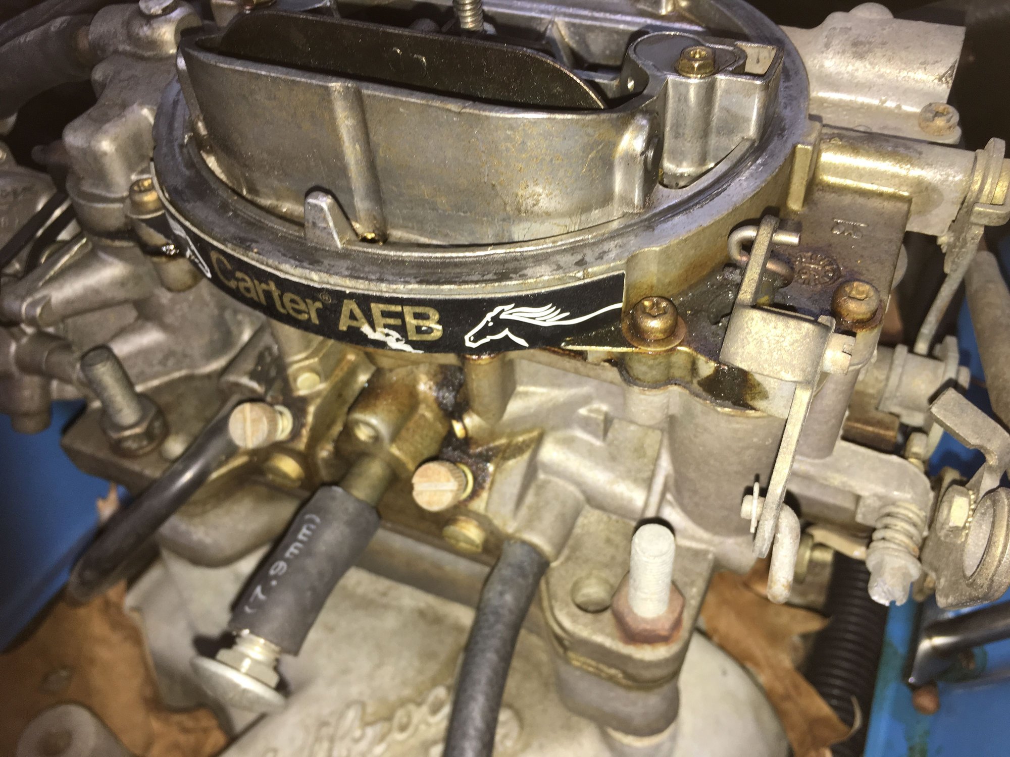

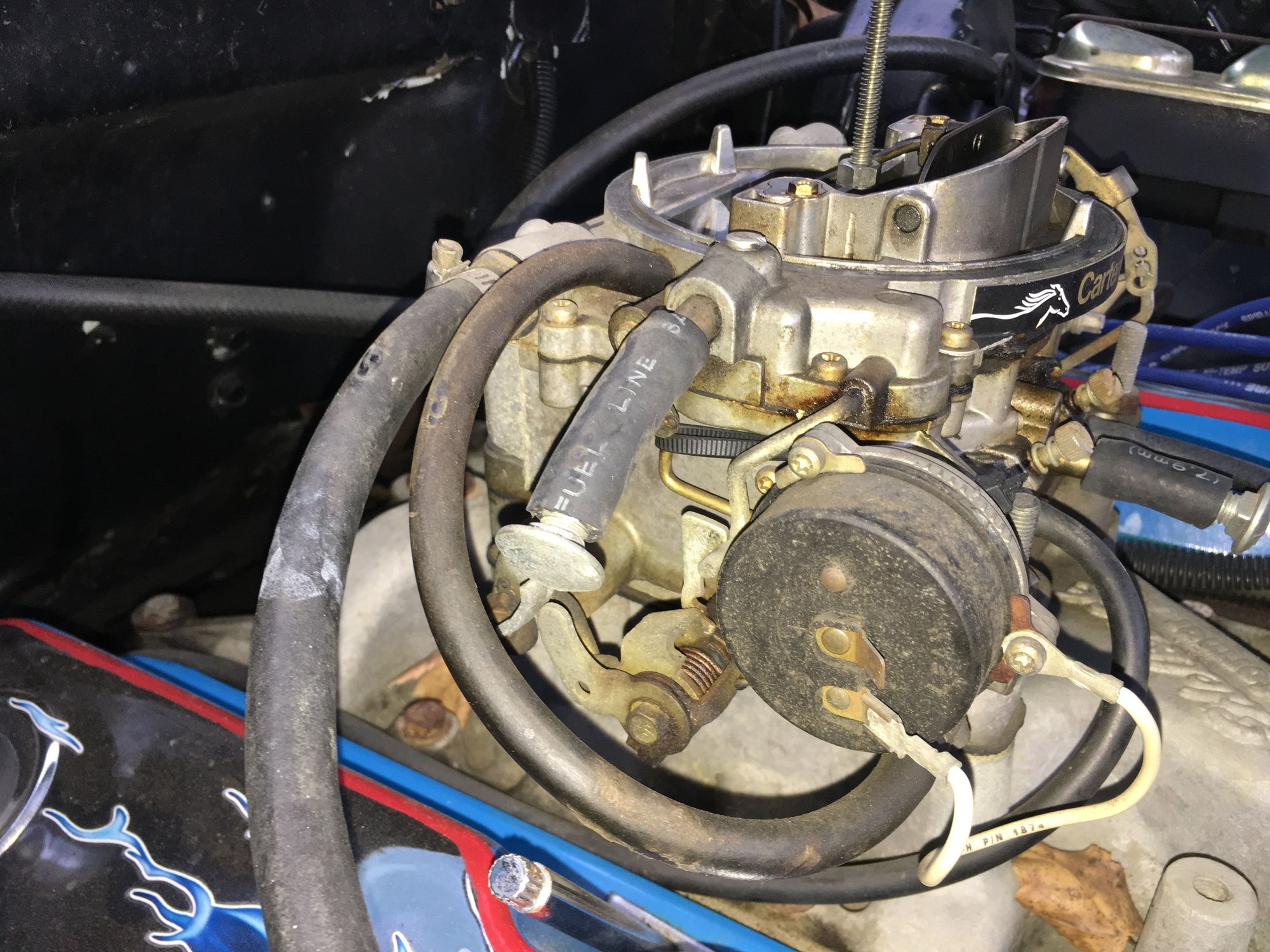

What does this cable tie hold?
is the upper hose with bolt blocking it off a vent for the float bowl?
Lower hose with bolt blocked off is for PCV I think.
This is the best angle of the picture of the cable tie.

From: Barre Mass
Looks like the cable tie is holding the choke plate open. Do you live in warm climate?
Old Jan 27, 2017 | 02:07 PM
Hwklein88's Avatar
Hwklein88
Joined: Sep 2016
Posts: 77
I live in the piedmont area of North Carolina. We do have some warm summers but also have some cold winters being near the mountains. For the float bowl and PCV what would you recommend i do? Sorry this is the first truck i've ever had thats had a Carb so i'm still learning. Thanks!
Old Jan 27, 2017 | 02:17 PM
Brian1971f100
Joined: Mar 2016
Posts: 1,412
From: Barre Mass
Just leave the float vent open. If you are running a PCV valve then that hose would run to the valve cove with PCV valve in it and other valve cover would have a fitting that hooks to the air cleaner body. If no PCV valve then leave it plugged.
