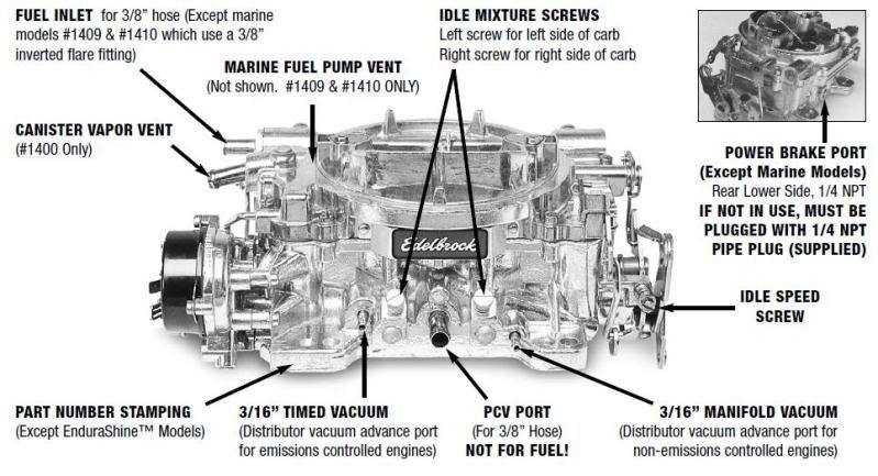

Just leave the float vent open. If you are running a PCV valve then that hose would run to the valve cove with PCV valve in it and other valve cover would have a fitting that hooks to the air cleaner body. If no PCV valve then leave it plugged.
according to this it looks like thats an emissions vent. Leave the vent open still?
Old Jan 27, 2017 | 03:01 PM
Brian1971f100's Avatar
Brian1971f100
Joined: Mar 2016
Posts: 1,412
From: Barre Mass
I would. Most likely to go to a charcoal canister.

Not the same but when I googled it edlebrock came up.
Since i do not have a carbon canister it should stay plugged unless it rigged up and ran to the air filter?
Old Jan 27, 2017 | 03:24 PM
Brian1971f100
Joined: Mar 2016
Posts: 1,412
From: Barre Mass
Yes you can plug that. I don't think it make a huge difference ether way. You need to concentrate on getting the choke to work, and adjusting the choke. Then see if the truck runs better.
