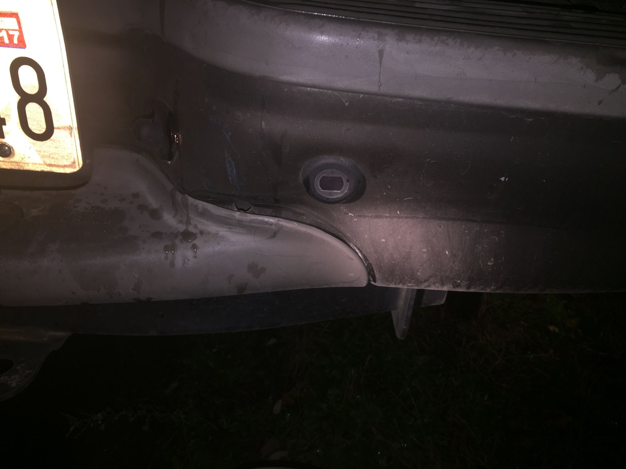

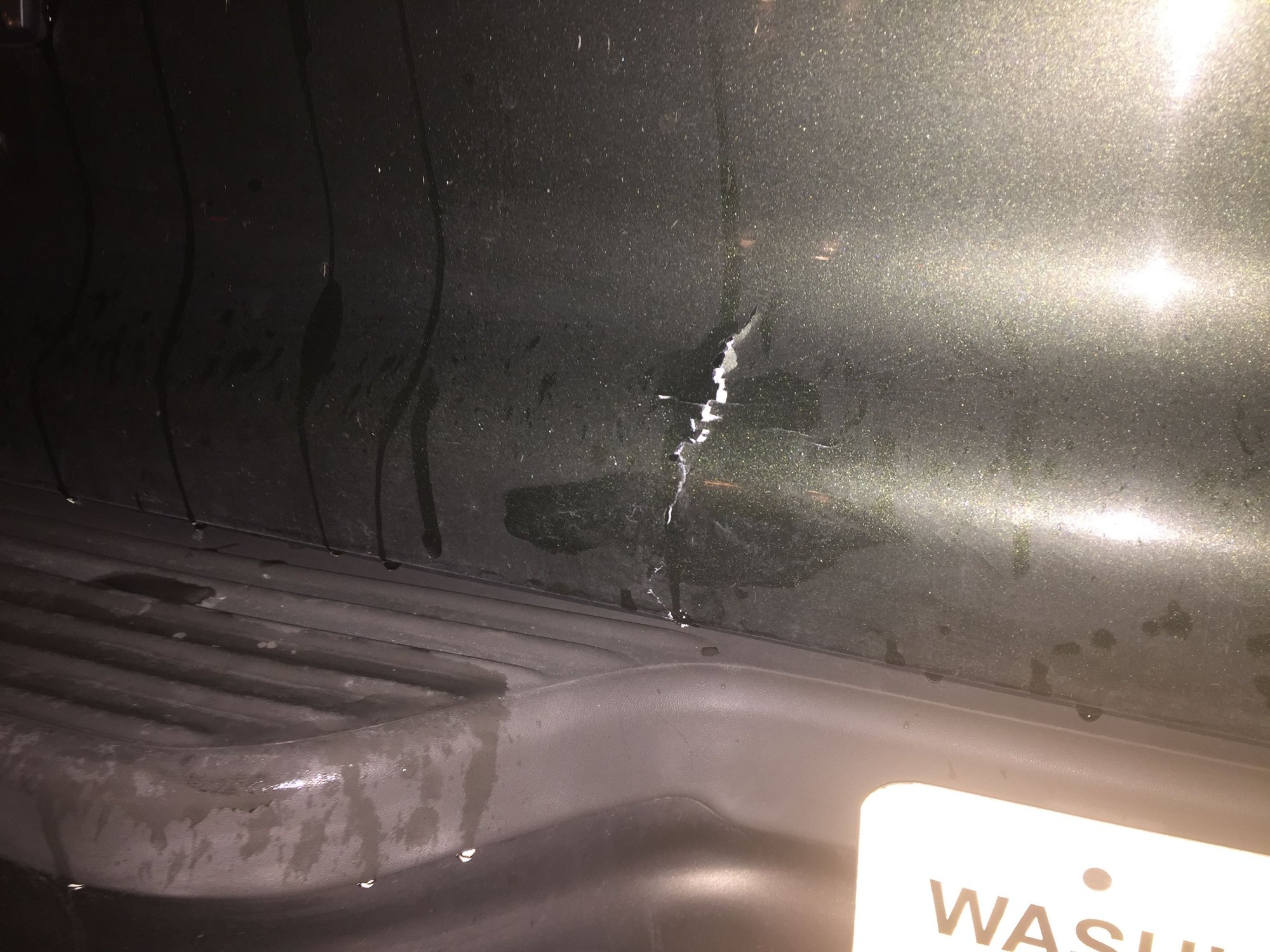

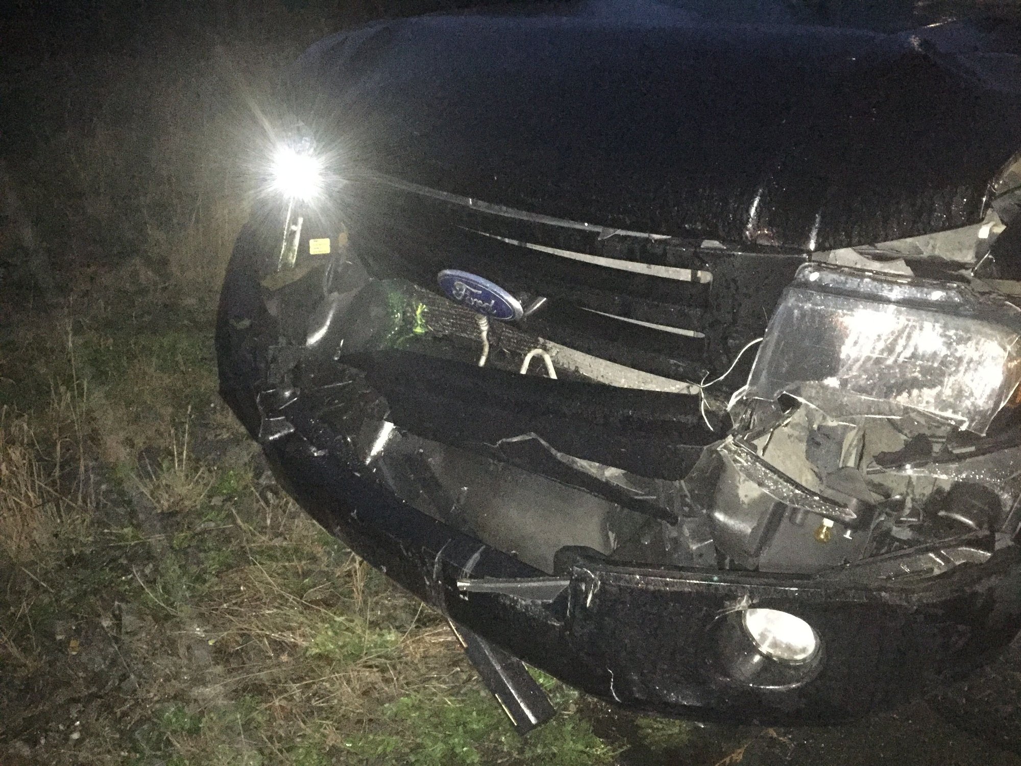

Here is my Plug and hitch after getting rear ended by a Nissan. I just bent it back out with a pry bar and put the plug back in.
BigGreen did you miss your hitch backing up or something else, it looks like you grazed something? Your plug looks like it got crunched is it reusable or did you order a new harness. Mine was deformed so I had to bend it back into shape, but it still works great.
I so need to do my undercarriage both of your shots are so rust free.
No we got rear end d by an F150 who got rear ended by a Expedition. She was doing about 45 or so when she plowed into the kid who then hit us, the two victim vehicles were both at a dead stop. The picture is just the plug bracket, but the bumper and the rear drivers side barn door all need to be replaced also. Should be going in when the receiver arrives.
