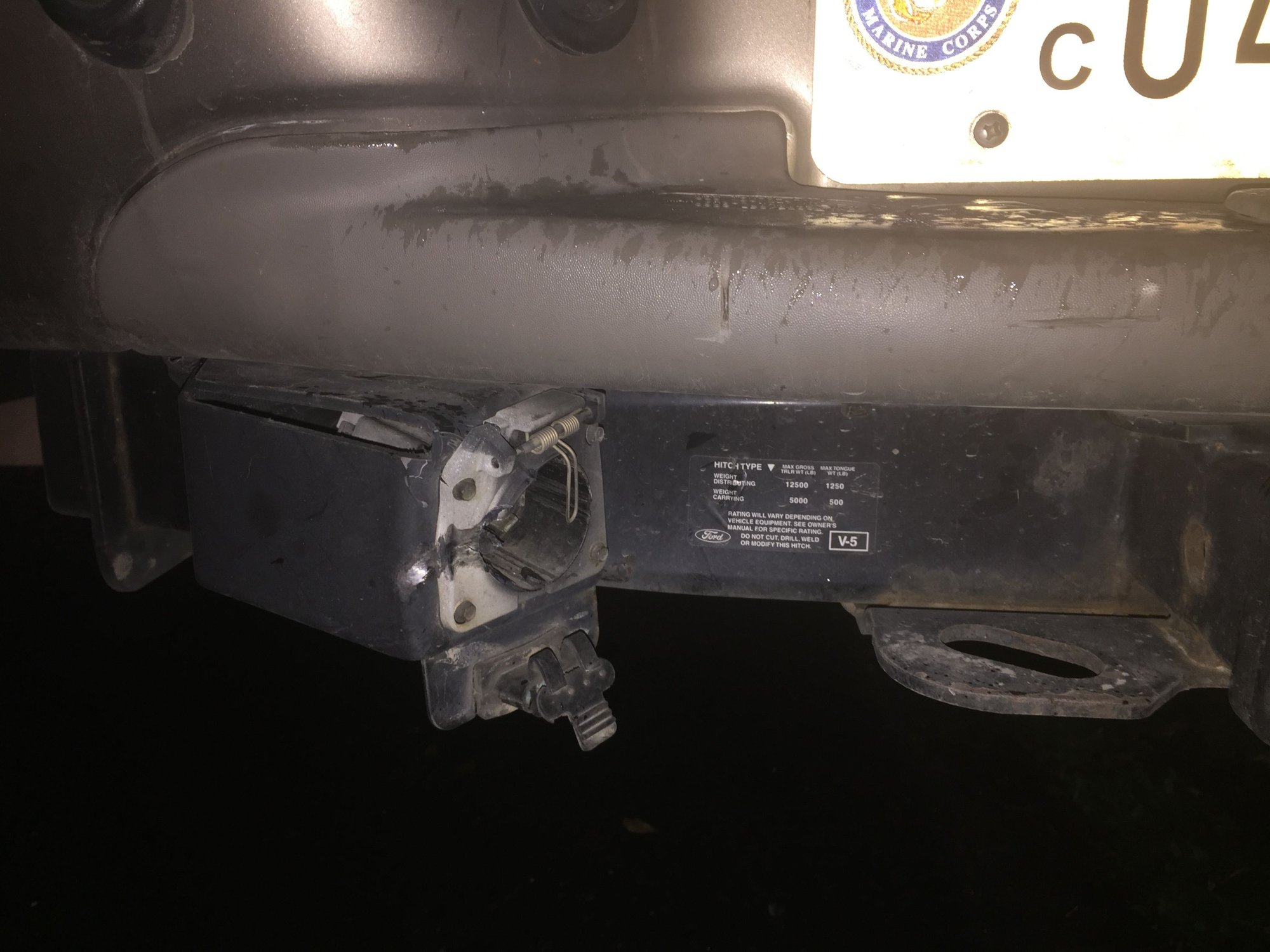

You mean this kind of protection?

Actually yes, that kind of protection.
What would be left of it if it were made from thin sheet metal? All you need right now is a new 7 pin plug socket and a few minutes in the vice and a hammer. How bad is the damage to the rest of the hitch? Or did the plug bracket take the impact?

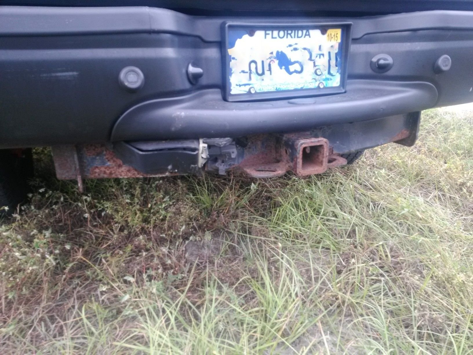

This looks like a nice hitch, but why would you need a double socket or a 20k? I must be missing something to justify this upgrade Tom. Nice write up by the way!
Here is my Plug and hitch after getting rear ended by a Nissan. I just bent it back out with a pry bar and put the plug back in.
BigGreen did you miss your hitch backing up or something else, it looks like you grazed something? Your plug looks like it got crunched is it reusable or did you order a new harness. Mine was deformed so I had to bend it back into shape, but it still works great.
I so need to do my undercarriage both of your shots are so rust free.

The double socket is just how Torklift makes these, it's used for an extension on a truck camper. The weight capacity is the key. Not hard to find a trailer that goes over 1300lb tongue weight. I'm planning to fab up some sort of a bike rack to fit in the second socket while towing my trailer.
Does that Florida truck live on the beach?

O yeah backing up the Yacht into the ocean eats it up ask LivingLarge(Mark)!

I know, I wasn't trying to be a smart a**. We got hit pretty good so insurance is paying for the hitch and a new plug bracket, I won't be pounding the dent out of this one. I just ordered my new SuperHitch and plan on doing a retrofit similar to the one you posted pictures of. Shouldn't take to long to get as they are only an hour or two south of me. Good time to update because insurance is going to pay for a portion of the receiver and the install. I think I'm looking at about $250 out of pocket to upgrade.

Replacing the receiver after a decent crash impact is always a good idea, especially if you tow a big heavy trailer like yours. $250 for the upgrade (and it is a serious upgrade) is a nice bargain, and you are going to love the SuperHitch, this thing is beefy!
