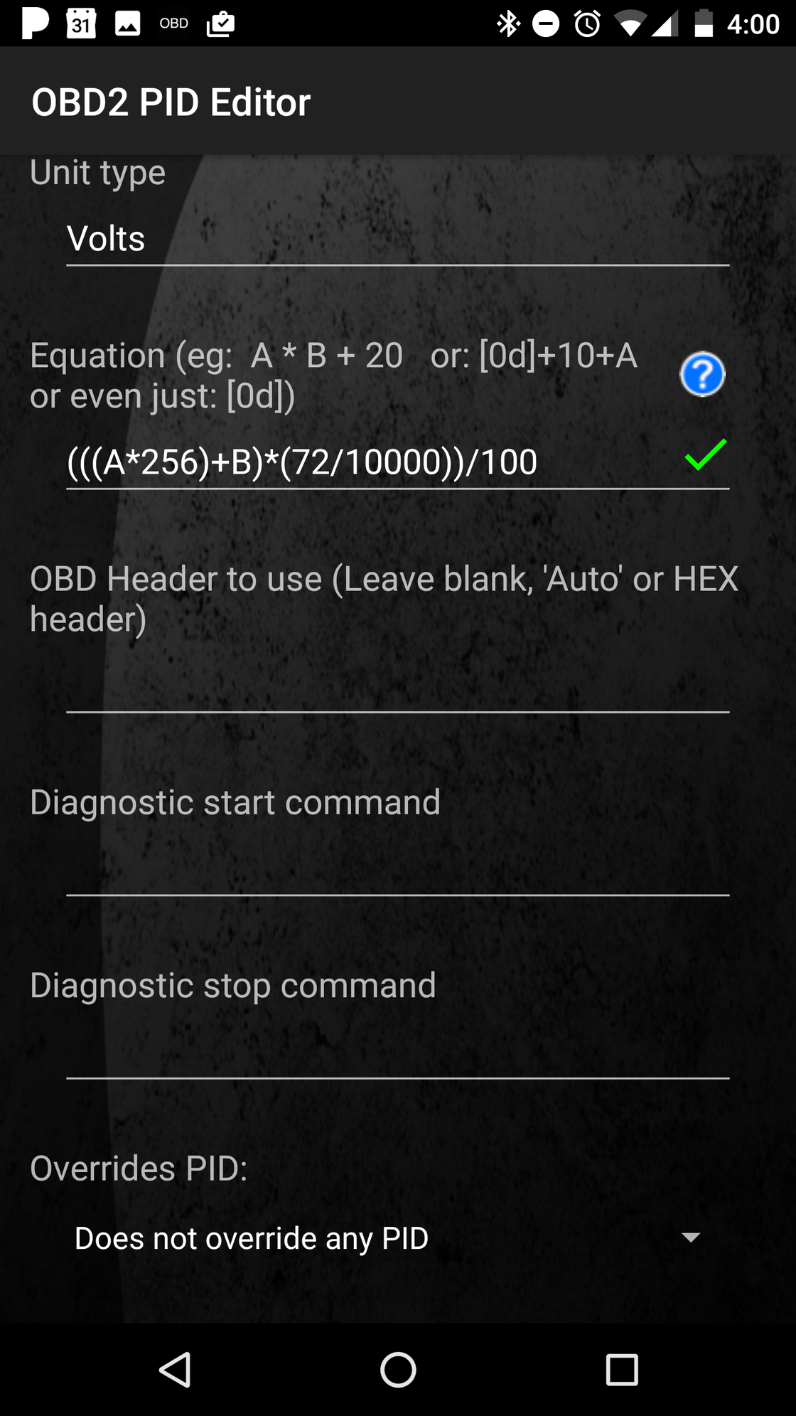

Sorry I forgot that it's a custom PID. Here you go.

Ok, I put the ICP Voltage PID into my Torque app, and I got 23 volts koeo, 24 cranking. Isn't it supposed to be around .2 volts??
Old Jan 17, 2017 | 06:36 PM
seijirou's Avatar
seijirou
Joined: Aug 2012
Posts: 2,857
Likes: 936
From: Kaufman TX
.8 to start. Double check the first hex entry and the formula.
