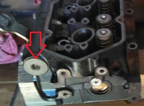

Look at your oil level tube adapter on the oil pan and make sure the copper washer on the drain plug is sealing. Could also be what you mentioned or even the head oil galley plug O ring.

No meaning to high jack but there are oil plugs in the he head? I have oil leaking from the drive side rear of my engine and i replaced both the valve cover gasket and breather orings and I still have oil coming down

look at front of the head, there is one similar to it on the rear in same line that gets heated by the exhaust and fails
