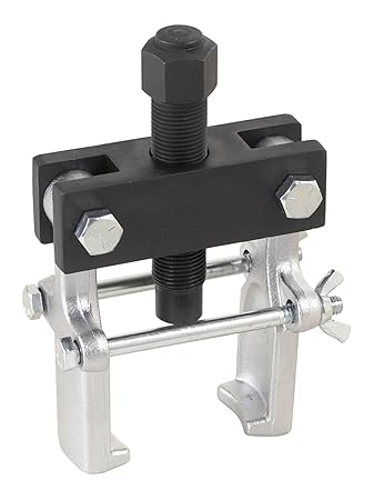

Don't know what year truck you have, or what kind of puller you're using that the diff is in the way, but I got one of these to remove the arm from my '97 Land Rover Discovery and it worked great (even though I still had to use a cheater bar on the breaker bar).
OTC 6497 Front End - Pullers
