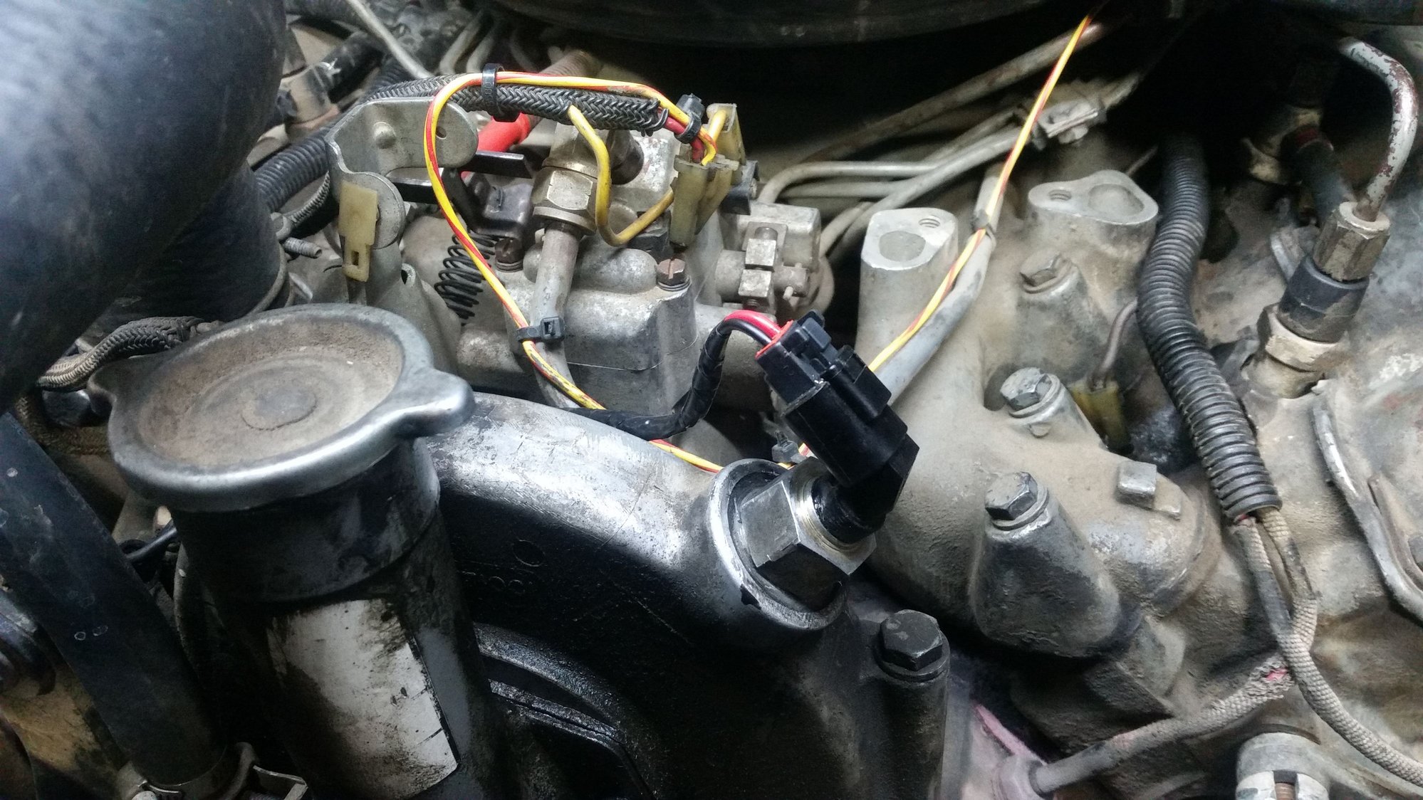

For anyone installing the Honeywell Variable Reluctance sensor for Perkins engines
The plug use is a DEUTCH DT06-2S It will allow you to use a plug rather than grinding away the plastic and soldering to the wires.
Here is an amazon link
https://www.amazon.com/Deutsch-2-Pin...ywords=dt06-2s
Here is a link to the sensor I ordered, I would highly recommend this seller as they were great to deal with!!
http://www.ebay.com/itm/321807525158?_trksid=p2060353.m2749.l2649&ssPageName=STRK%3AMEBIDX%3AIT
Here are the pics!
Drilling out the factory sensor.
I was planning on grinding away the plug side of the sensor and soldering as I had seen suggested before. As I was about to do that I remembered seeing a leftover plug in my junk drawer that looked similar. It was a leftover plug from some auxilary lights I installed on my MC. It just so happened that it was a perfect fit.
Finished product for testing
Tested fine so now for the epoxy.
The plug that fits is a deutch plug model number DT06-2S
Installed

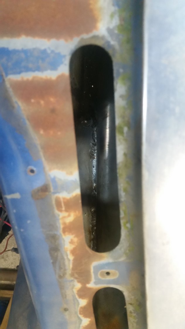

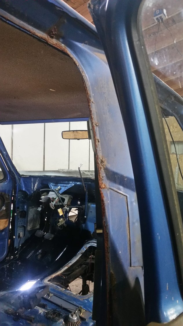

POR-15 is made by the devil himself.. I got some of it on my hands a couple days ago and have not been able to get it off even scrubbing to the point of my knuckles being raw. Damn does it stick to metal as well though.. I had a spot I was trying to clean the rust beside and was wire-wheeling it. The wheel did not even scratch the POR-15 but took the rust next to it completely off..
While beginning to spread POR-15 on the drivers floorpan, i pulled the door seal off to this surprise... Should have thought of that first but it shouldnt be too bad to clean up.
So.. Does anyone have any clue what these are? These are on each A pillar. I am guessing it is a sensor of some sort, likely for an alarm system.. They have a rc-phono plug on the other end.
Well I was cleaning around the window and noticed that it moved when I pushed on it. Pushed on it a bit more and it broke.. Well I guess I am installing a windshield.. It needed it anyhow as it was cloudy in a few spots. It is pretty obvious that the windshield was leaking in this area..
I even had some flora growing on the passenger side bottom corner
Interior has now been fully prepped and ready to seal, I pulled the rear window out as well and will seal around it with POR-15 also..
