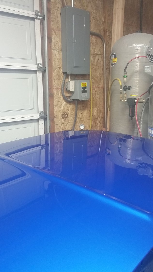

The reflection in the hood is phenominal after waxing!
This is the spot I sanded through, back to shiny!
final polish is done and wax is on! Now to start installing the glass!

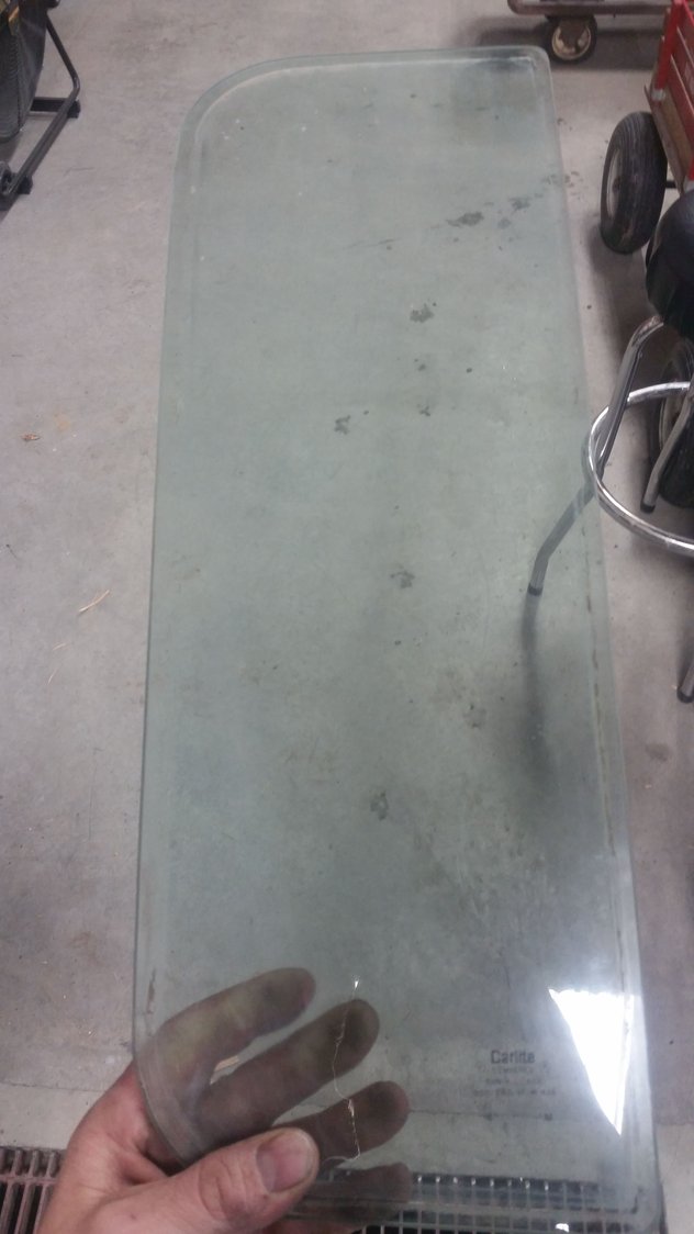

I was unable to find an replacement seal for the front portion of the windows on the rear doors. The seals were still flexible with only minor weathering so I sanded the weathering off with 180 grit and then wiped them with acetone to clean the dust off. They ended up looking pretty good!
I cleaned the glass with 0000 steel wool. This is before cleaning
This is after.

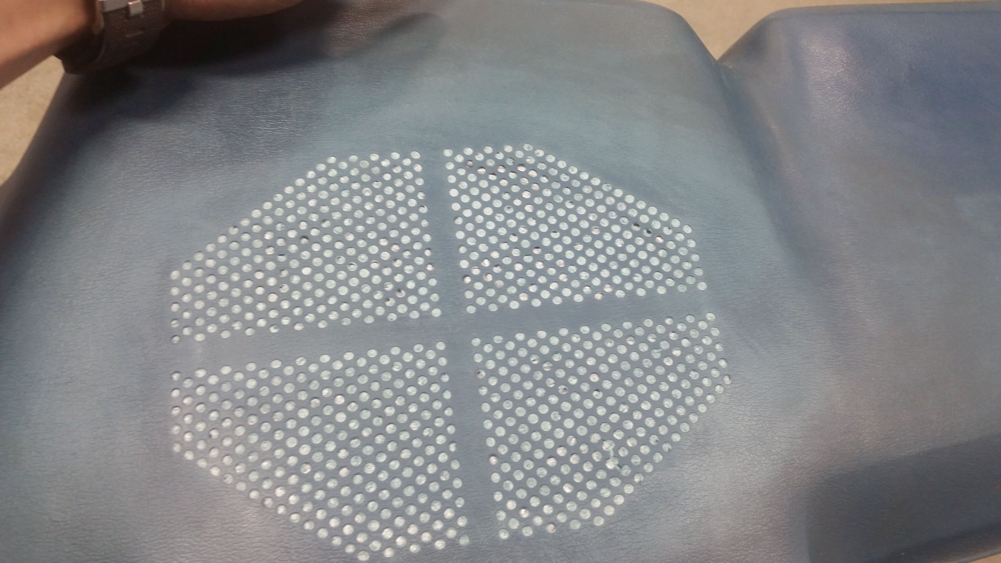

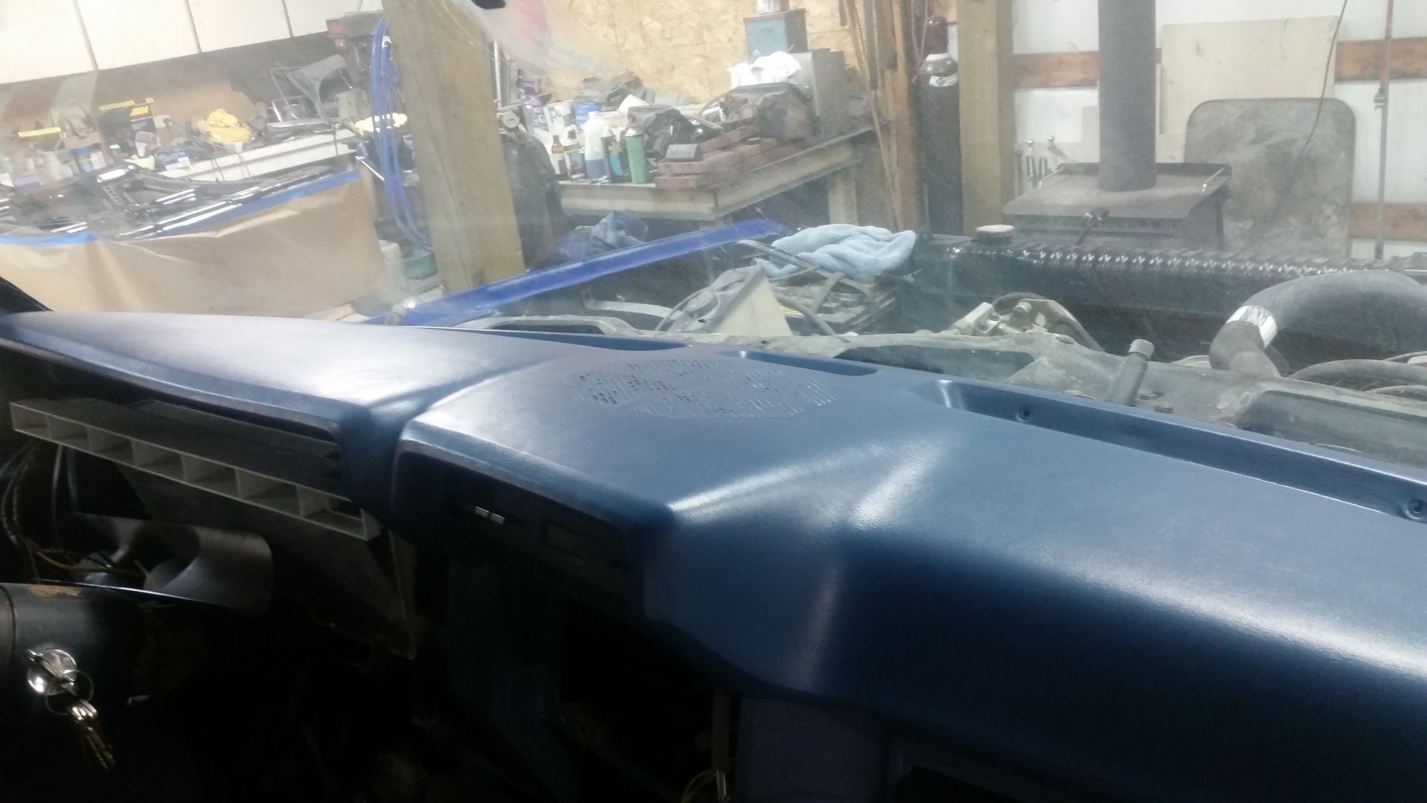

Since the speaker hole is well known for cracking out and mine was in good condition i reenforced it with some leftover seam sealer.
All of the trim ready for painting.
Dashpad after painting.
Rear window is now in!
Windshield installed.
I figured out why the seatback on the drivers seat was sagging...
I welded a piece of angle iron in for reenforcement.
The seat foam i glued back togetjer with contact cement

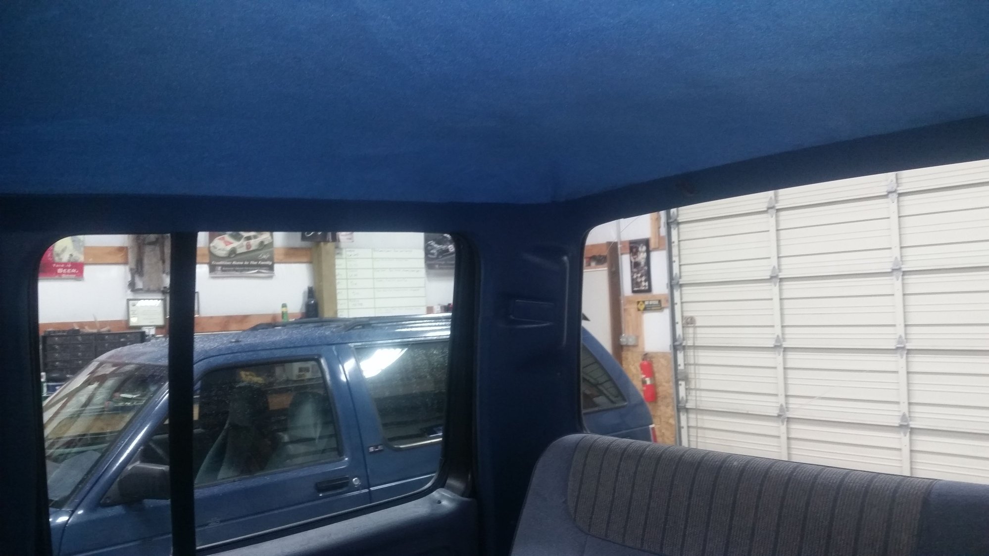

Flash didnt catch it well but the interior is assembled!

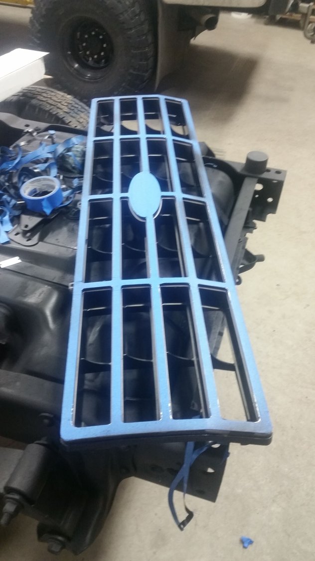

I ended up having to trim the hood latch 1/2 inch or so to allow clearance between it and the AC condensor The one on the right is now on the truck, the other is for comparision.
I modified it a bit more after this pic, it now clears with a "tiny" bit of room
I didnt like the grille having silver on it, so I taped off the chrome and painted it the same satin black as the remainder of the vehicle.
There were some slight miscalculations made.... I forgot about the clearance for the lower valance. When I tried to put it on, it and the ac condensor tried to occupy the same area... I managed to give it slightly more of a bend on either side, which was enough to allow it to fit.. Barely...

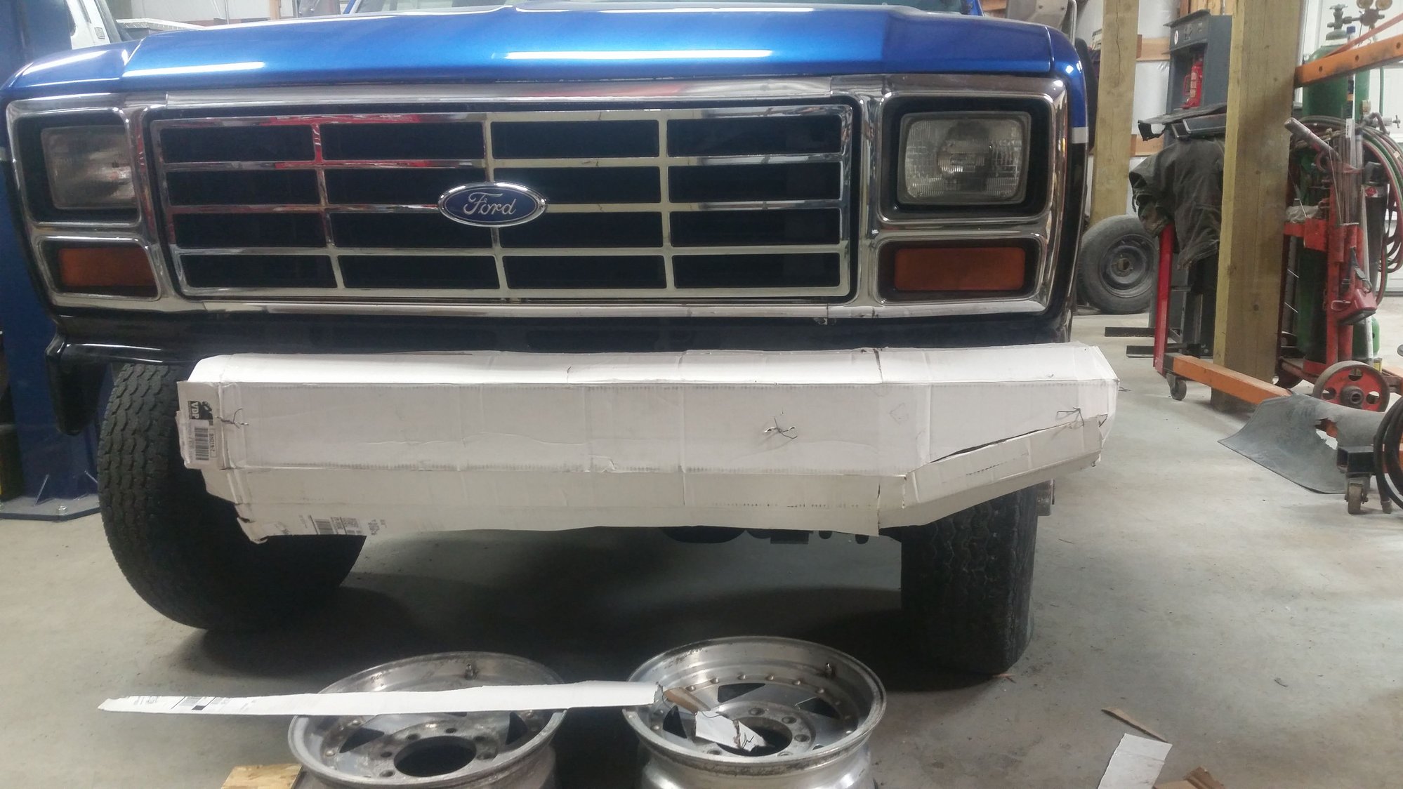

I did an initial mockup of the bumper with cardboard, currently I am working on designing it in Solidworks, afterwhich I can cut it on a cnc plasma, bend it, and weld it together.

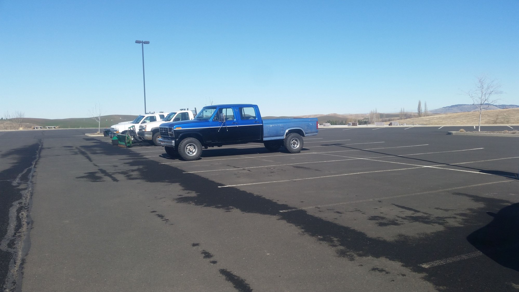

Well, it has been a bit since I have made any updates. But I am currently in the process of buying a house so the bed and bumper have had to take a back-burner for now. To make the truck drivable I put the factory box and bumper on last Friday and so far have about 500 miles on it. Currently it is running great, making about 18 mpg and pulls hard. Best estimate of power would be similar to a chipped last Gen 7.3 powerstroke. It looks a bit funny with the mismatched bed but it is sure nice to be driving it.
