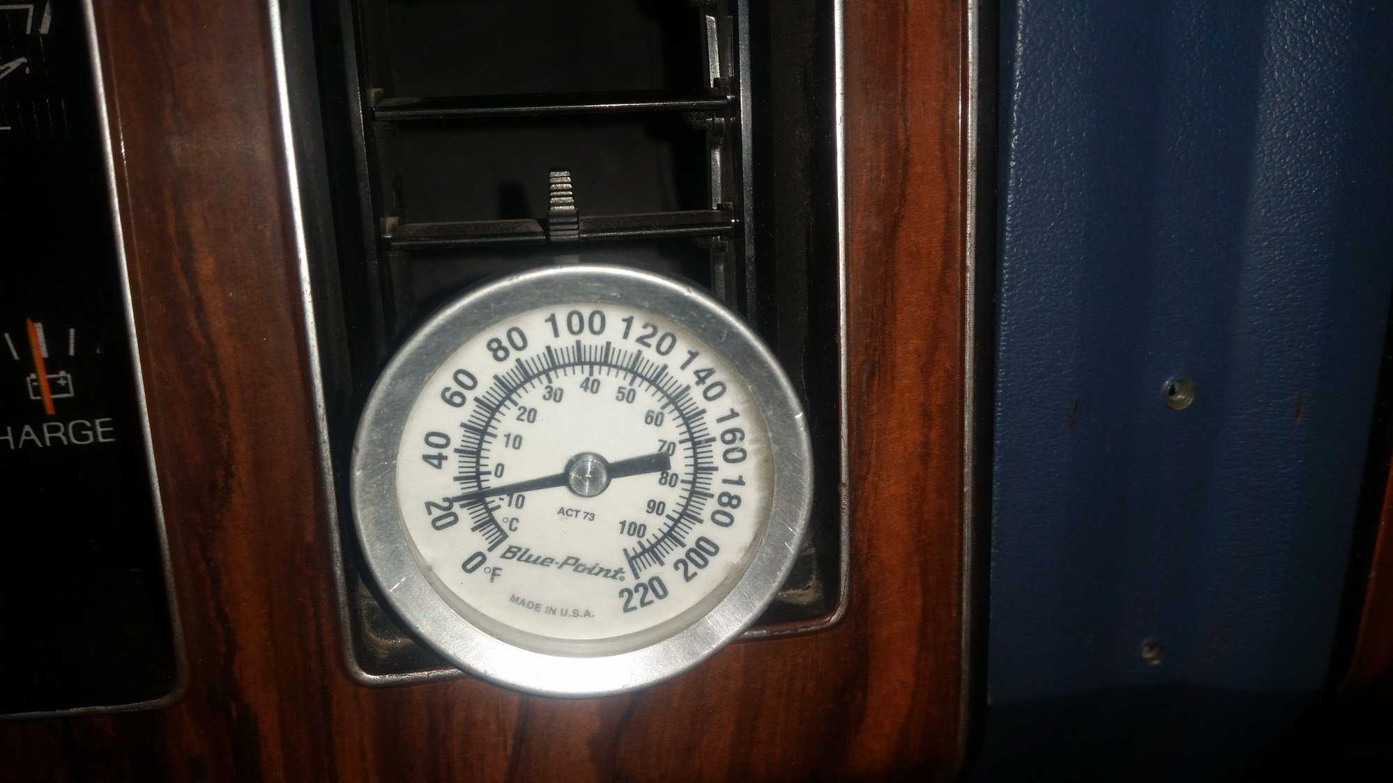

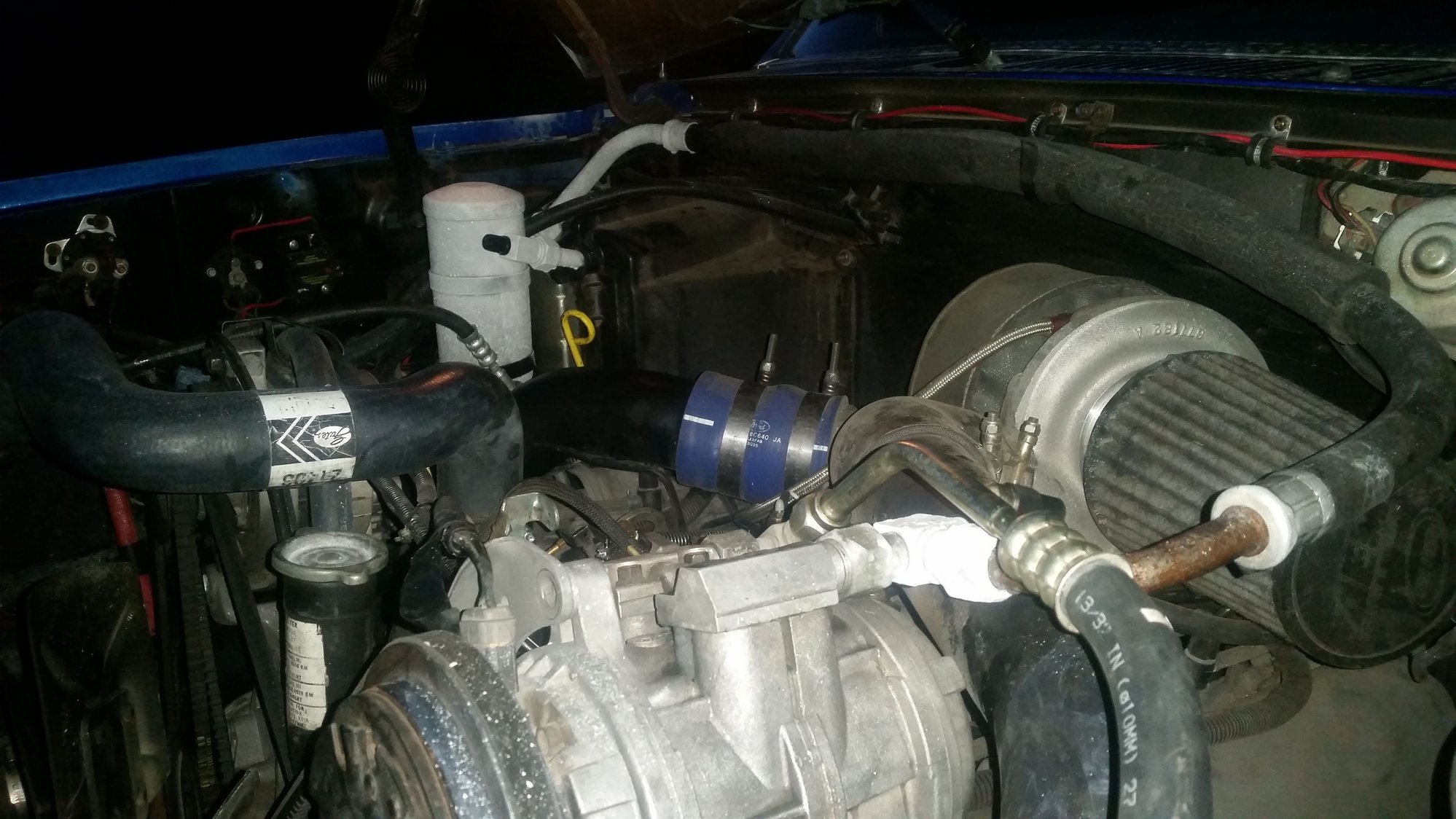

A/C system is workin very well!! I didn't want to use r134 as it doesn't work well in systems designed for r12 so I mixed up my own refrigerant. I DO NOT RECOMMEND TRYING THIS AT HOME THERE ARE RISKS ASSOCIATED WITH USING REFRIGERANTS WITH A LOW FLASHPOINT. I used a mixture of 79% r600 and 21% r290. Otherwise known as propane and isobutane. Current vent Temps are 22°F I have to be careful to ensure that the fan is not run on low or it will freeze up the evaporator core, noticeable when the airflow stops. .. Wife is impressed but not impressed, I have seen her wearing 2 sweaters in the cab when it was 90°F outside.

Impressive vent temps, I'm running that envirosafe propane/isobutane refrigerant and haven't seen below fifity unless driving through a rain storm

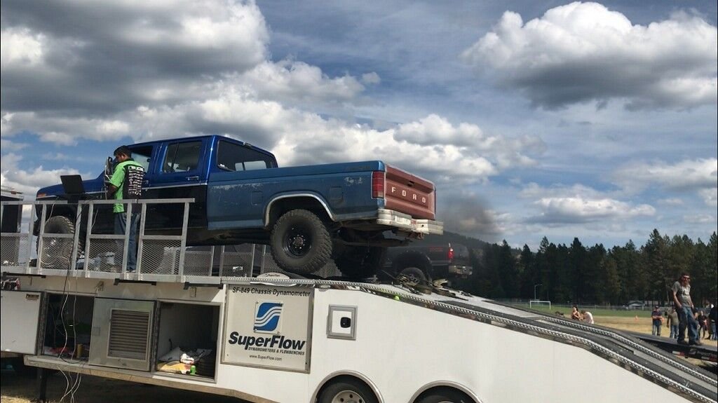

R&D bronco on the dyno
R&D bronco first run
R&D bronco second run
I decided to take the old beast to hunting for horsepower yesterday. I had not planned on running on the dyno but after about 30 tries to convince me from 03wr250f and a couple other friends I caved to peer pressure. My original intention was to run on a local dyno where I could get torque numbers as well rather than the portable dyno at h4h but my curiosity got the better of me.
On they dyno I put down 232 on the first run and 237 on the second. The max boost I hit was about 15psi which is lower than the 21 that I am able to consistently hit on the street. I was still putting out a bit of smoke although it had cleared to a light haze once I had spooled up to 15 lb. After talking with several others who ran that seemed to be the norm. After talking to the dyno operators, the dyno we were running on was only a 20% load dyno so that would explain a lot of the results. I may still have to run on another dyno just to verify what I am making as well as get some torque numbers. I personally think if I were spooled all the way I may make a couple hp more but honestly I am very happy with what I am making. This rig was intended to be a solid reliable family vehicle and it meets that purpose perfectly.
After the dyno run I was able to talk with a bunch of other IDI guys and compare setups. Macrobb was there as well as Racingndrummin, and I got a couple videos of the R&D bronco running on the dyno and the dirt drags. As well as a 33 minute video of the inside of my pocket, the beginning of which is my gages while running on the dyno.
A great time was had by all and I will try to get some videos posted up as soon as I find a place to host them (YouTube ticked me off so I no longer have an account with them).

I saw this truck at H4H yesterday. I am extremely impressed. Pictures do not do the paint job justice - it's just amazing!
Also, the engine bay is very very clean and well done. Again, you look at pictures and go "Yup, there's the turbo, that's an IDI", but don't really notice the... lack... of wiring until you see it in person.
The dyno we all ran on at H4H was only loading to 20% or something, and yeah, it just kept producing disappointing numbers for everyone involved - stock setups that didn't need much load weren't hurt much, but anything that needed to spool(like my own S360 setup or Justin's bronco) just felt like we weren't getting good results.
