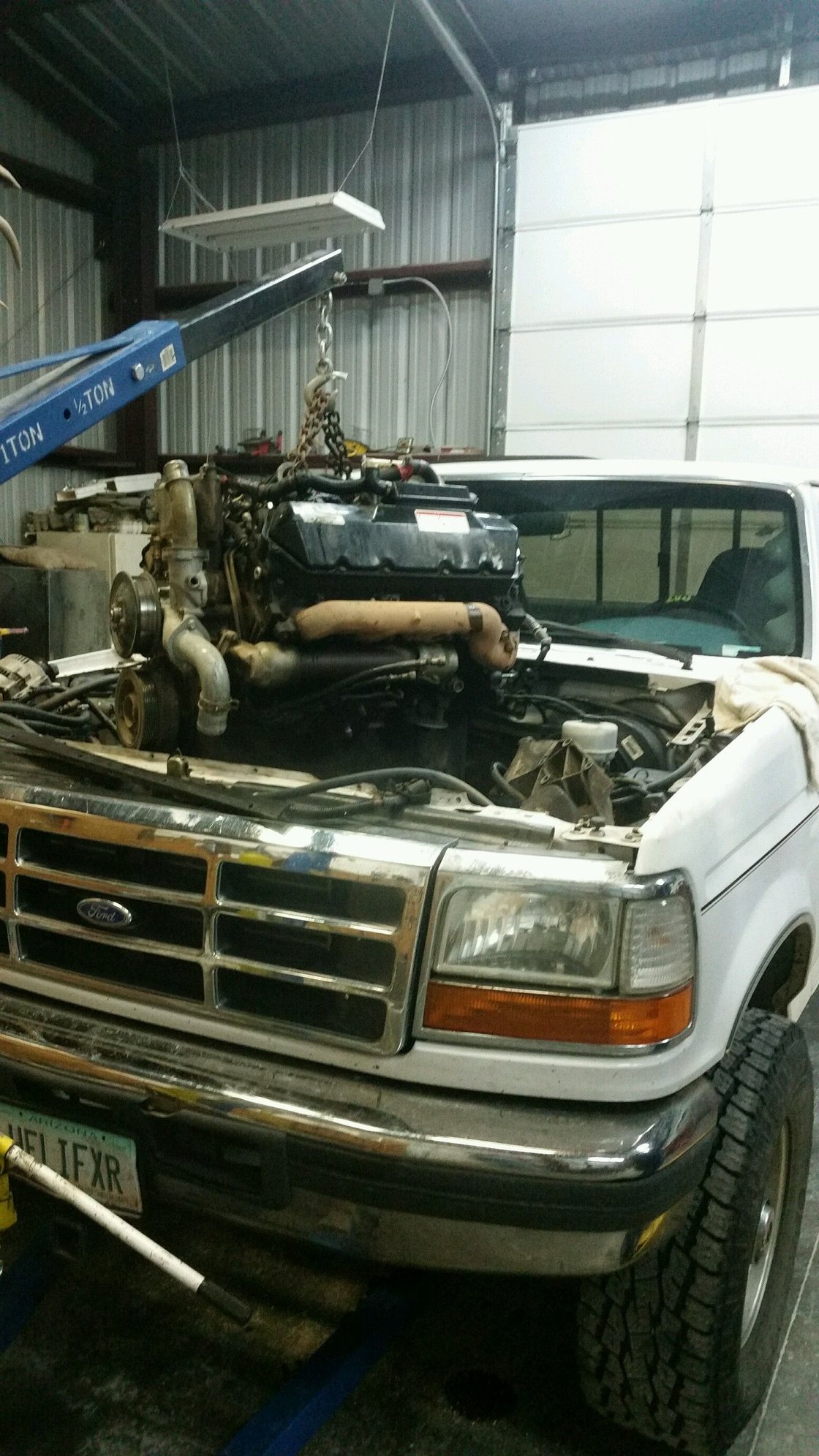

pulling to motor truly is not all that hard. Once the radiator and core support are out, it's a matter of disconnecting the main harness and transmission/fuel lines and that is about it! Pulling a Subaru motor is more time intensive.

I can do it in 8 hours on my truck which is a 5 speed, with a standard trans the trans has to be removed first.
with auto just unbolt the torque converter and trans bolts, disconnect wiring harness drain cooling system, remove fan, radiator, ac compressor, ps pump and alternator. disconnect down pipe, dis connect fuel lines, move harness at firewall up and remove plastic loom holders. remove nuts from motor mount studs. support trans lift motor over mount studs, move forward than rotate 45 degrees and lift out

I pull the turbo and oil filter also
