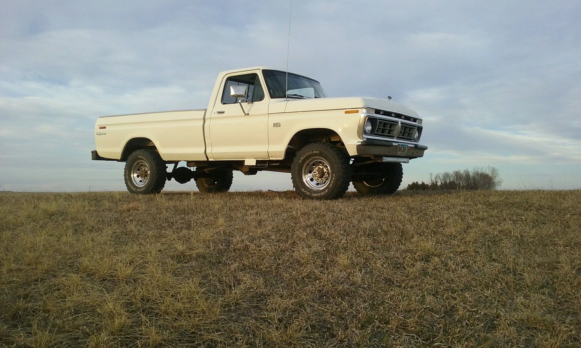

Icic thanks I will have to look into getting that... Well this is the pickup I am so curious about. And that is the emblem that is on the hood.

Ford Custom with Explorer package, but the front bumper isn't the original. With the horizontal bumper pads, it's from a 1973/77 Ranger XLT.

What does the original bumper look like? And what trim would I be missing do u think?

Chrome front bumper without horizontal pads same 1973/77 F100/350 & 1978 F100/350 before serial number AG0,001.
