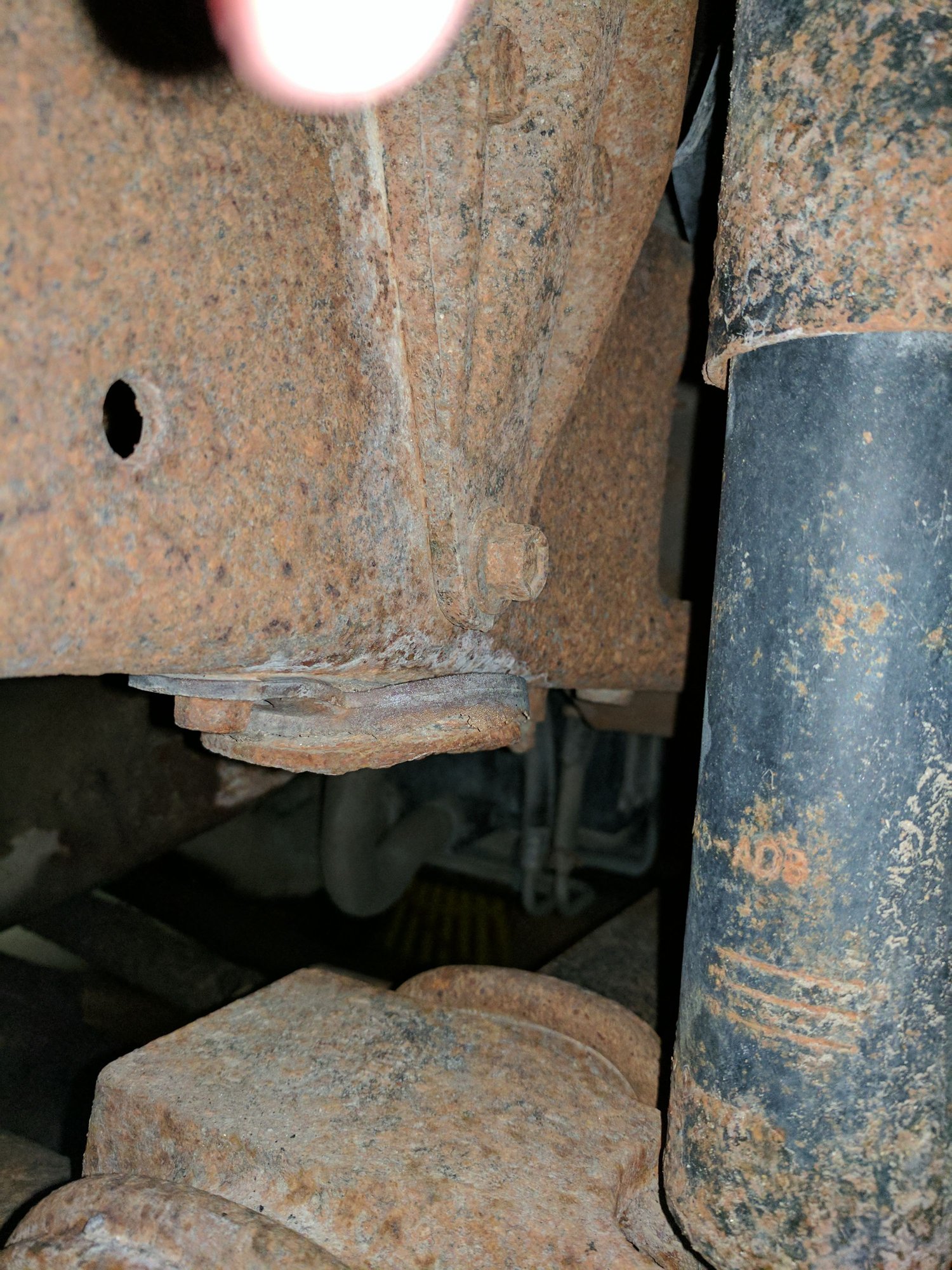

pirate4x4_camo I just went out and measured here are all four corners from center of hub to bottom of wheel arch:
Driver's front-22"
Passenger's front-22 1/2"
Driver's Rear-23 1/2"
Passenger's Rear-24"
I have also attached some pics, and it looks like my bumpstops are gone from the front completely which concerns me more that it's hitting frame basically. Shocks look stock to me , but hard to see numbers without crawling under and cleaning them. Driver's front
Passenger's front
Driver's rear
Passenger's rear

When your ex was delivered from the factory it had 23" front and 24" in the rear.
1/2" or so of sag is normal an should be expected. More then that I would recommend a new set of springs since the Ex only has 5" of travel to begin with each inch is critical. (FYI....The F trucks have 8" of travel) I would measure yours again after you move the vehicle and compare to the first measurement since 1/2" variance can be from sitting a little crooked or if you made a turn right before parking.
Yes those shocks look original and even when they were brand new they sucked. Replace them and install a new set of bumpstops and at least your harshness will be taken care of.
