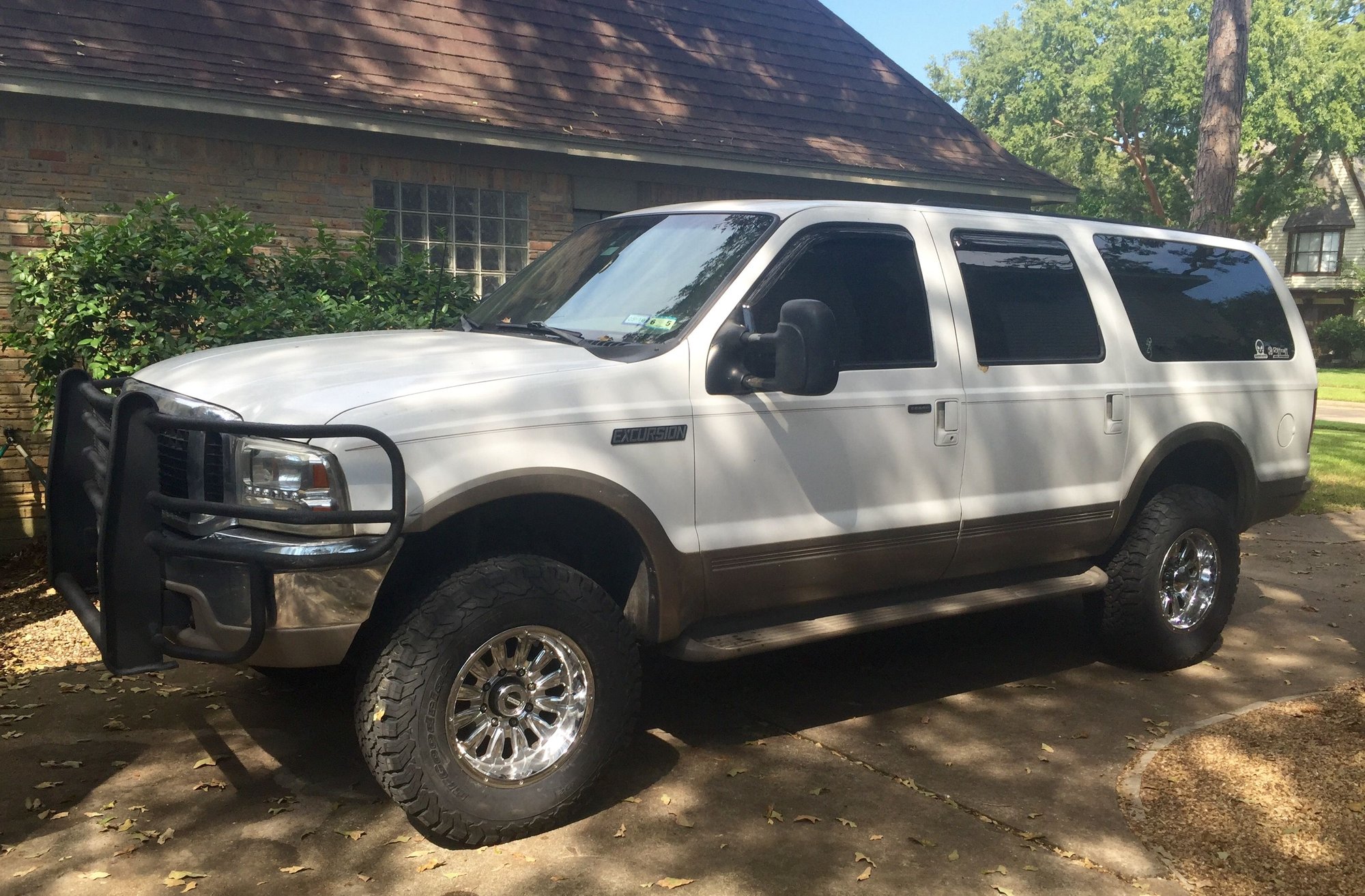

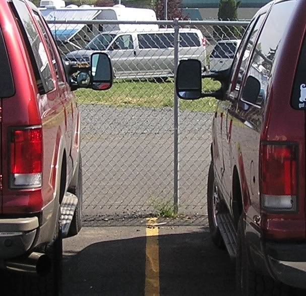

Wow, Stewart_H you don't get much of a better comparison than that, even the same color. It looks like you gained about 1.5 -2 at least or the the owner has some sagging spring as well. Nice looking ride by the way!

I went the ATS route (recommended) and gained about 1.5". I was nervous about the height change but get compliments and actually love the look. And it rides sooooooooooooooo much better. I went with whatever the "stock" spring spec was as a suggestion from Jr. (ATS).....new u-bolts and shackles....$400 installed and aligned. That does not include the price of the springs.....installation costs may vary.
Wow, Stewart you don't get much of a better comparison than that, even the same color. It looks like you gained about 1.5 -2 at least or the the owner has some sagging spring as well. Nice looking ride by the way!
I went to the thread I posted back in '06 and found I forgot to take before and after measurements, but that is the approximate gain for most, 1.5" to 1.75".
