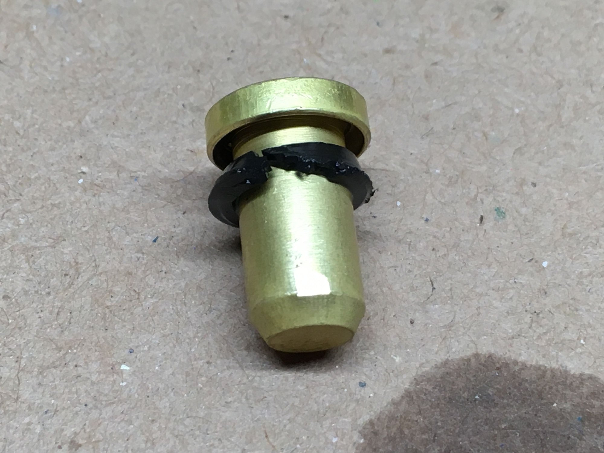

Just wanted to follow up. When I removed the cover on the fuel pressure regulator I saw this. Installed the new blue spring kit and problem solved. Back to 60-65psi.

Dang it I forgot to post on this the other night. I had one same issue except it was more random and was dropping to 35psi @ any more than 1/2 throttle.
Well, glad you got it. Here's what it looked like. Not as bad as yours looked.
Man that is wild that o'ring looks like that. Glad to see you got her whipped. Its always nice to find that "AHA" moment when you are looking for a the cause of a problem.
