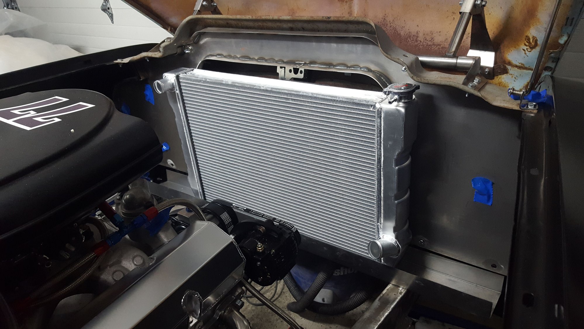

I am a fan of the crossflow radiator design...here is the one in my 56. The outlets are both on the same tank as the radiator is a dual pass. I built the core support from scratch so that I could eliminate the "hump" above the radiator.
