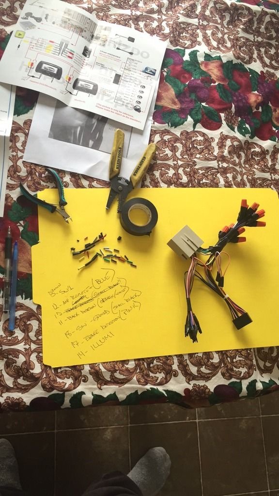

The harness is claimed to be "plug and play" but this is false. On the supplied harness there ignition lead is wrong and there is no dimmer. I have the XLT, so no steering wheel buttons and eliminated the CAN BUS decoder from the harness. You should buy a stock adapter and wire correctly:
You need to drill holes in the body and use the brackets from your old radio:

I installed this one in my 2004 EX Limited. It required no mounts and just slid right in tightly. A Metra Ford side wiring adapter was used. It required no other adapters as the head unit is programmable for the steering controls. Works fine and has 5.1 android loaded with 2 gig ram. I connect it to the internet via Hotspot on my phone. Google nav or the installed IGO nav works fine. Backup and dash cams and the OBDII devices from Joying are being used as well.
