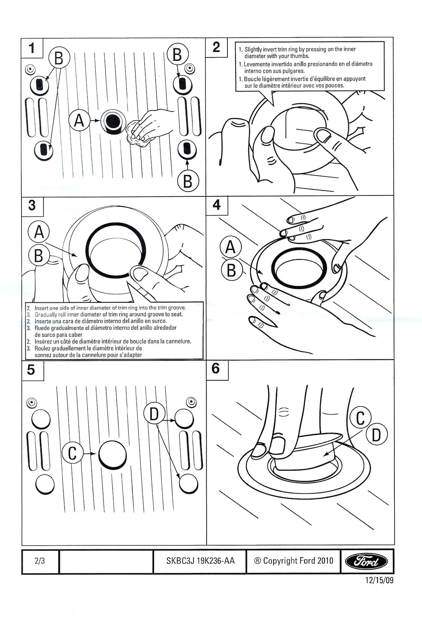

If the trim rings slide around, they were not installed correctly. See the installation instructions I posted above. The trim rings are a pain to get on but once on, they do not slide around nor pop off the cap.

This is with the stock rings and caps. I had the factory setup retrofitted to my truck, and the installers did the same thing that your dealer did, placing the rings over the pucks without seating the ring into the groove and then trying to hold them in place with the caps. It does take quite an effort to get the rings seated into the grooves, but as JustStrokin notes, once they are in the grooves they do not come out. I have had cargo push on the edge of the rings and fold them a little bit, but they seat pretty firmly against the sheet metal of the bed when they are properly installed.
