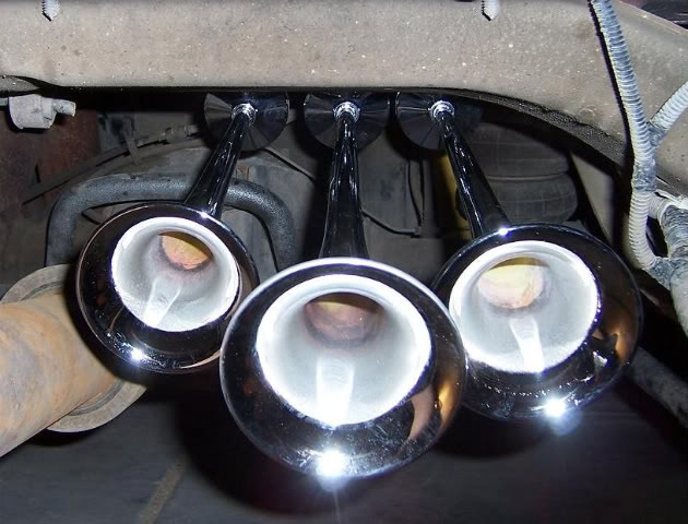

Right in front of the rear axle for maximum reflection off the pavement, and to keep it quieter in cab. Be heard, be safe!!

Old Dec 16, 2016 | 07:20 PM

William, can you post more pictures of how you installed that?

Holy crap that had got to be loud! where did you mount the compressor?

The bells came plumbed/assembled on a common bracket. I just bent up/drilled/painted some 1" flat stock to accomodate existing underbody harware. I installed my solenoid at the bells for almost instant on/off. For a more "train" like sound mount the solenoid away for fade in/out when you hit them.
Keep them pointed down so any water gets blown out at every event.
