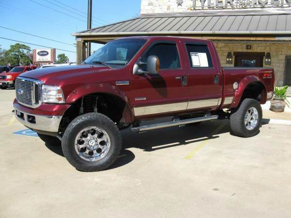

Unless you guys saw more pictures than I did...
What goes along with a Lift and a Banks Ram Air dust-your-turbo filter set-up?: Is more power, as in tuning. And one might want to trade that baby in once it has puked (degas residue), before something else goes blam-o...
OP: is the truck lifted and on some big meats? Because it aint just the oil filter cap that is higher and can go higher... Got more picts?

Walk away... Just my opinion, but based on what you have presented, there is no friggin' way in the world that thing wasn't tuned, and then some...
And it is a crap shoot with just a stocker...
