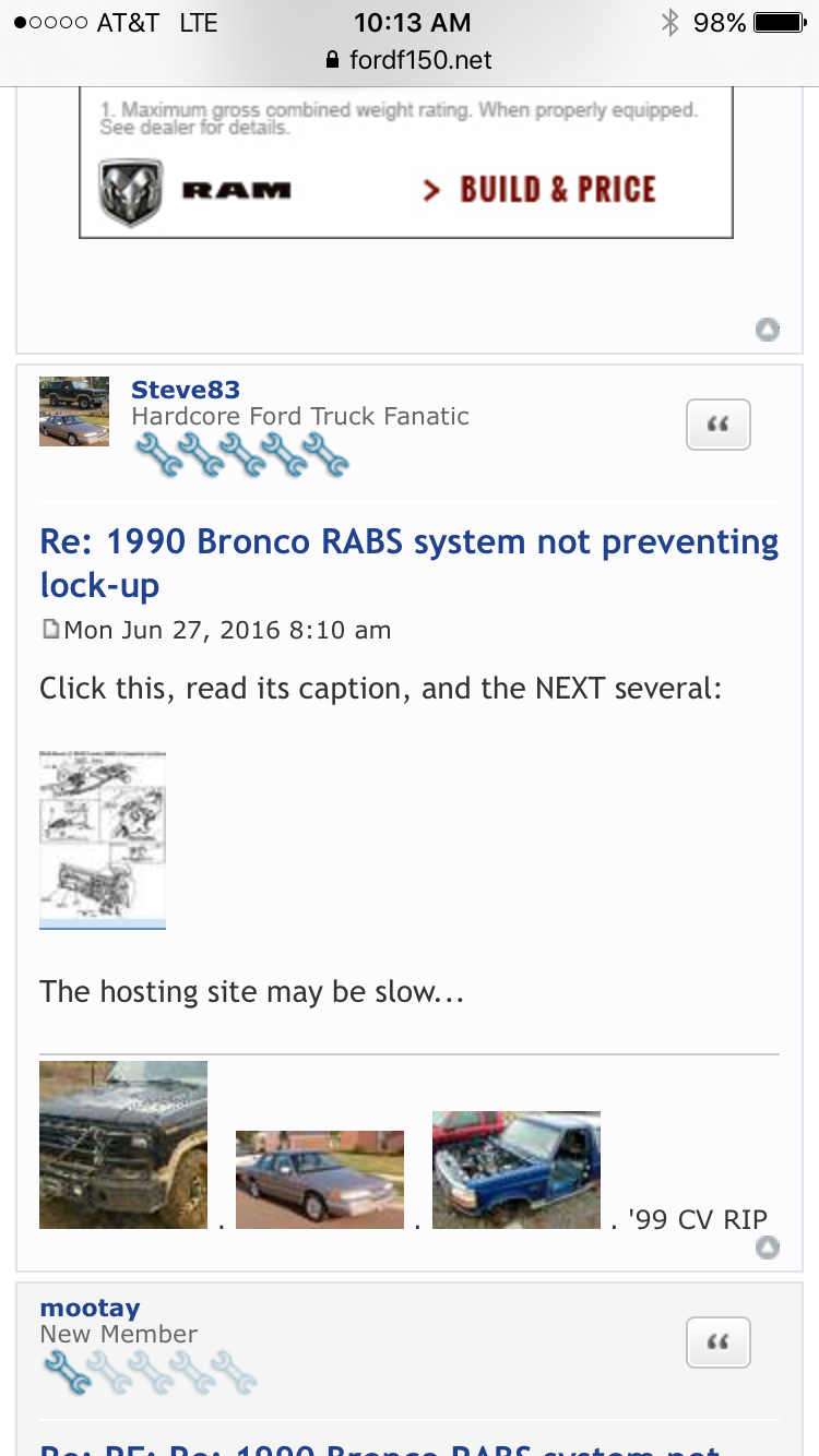

You should be able to retrieve a code and find out why the light is coming on. Found the testing procedure over on FordF150.net in this thread
I would have put in the link to it but not sure how.
