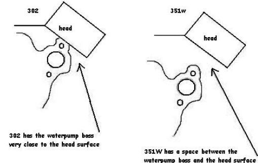

The easiest way to tell 351w from 302 at a glance is to look at where the timing case meets the drivers side cylinder head.
If flush or nearly so it's a 302. If there is 1/2" between water passage and head you have the taller deck height of a 351.

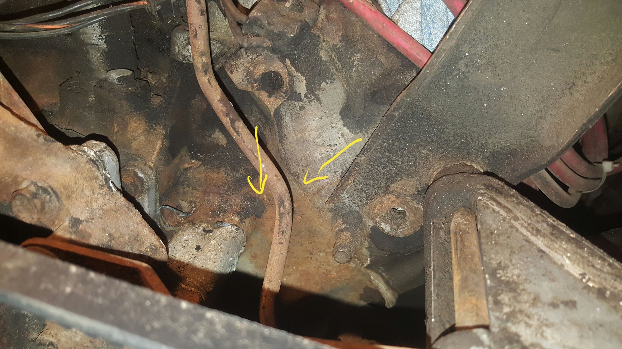

I guess 351?
Old Dec 16, 2016 | 03:21 AM
ArdWrknTrk's Avatar
ArdWrknTrk
pedant
Joined: Jan 2008
Posts: 23,576
Likes: 40
From: EXTREME southwest CT
Yes, that's a 351.
