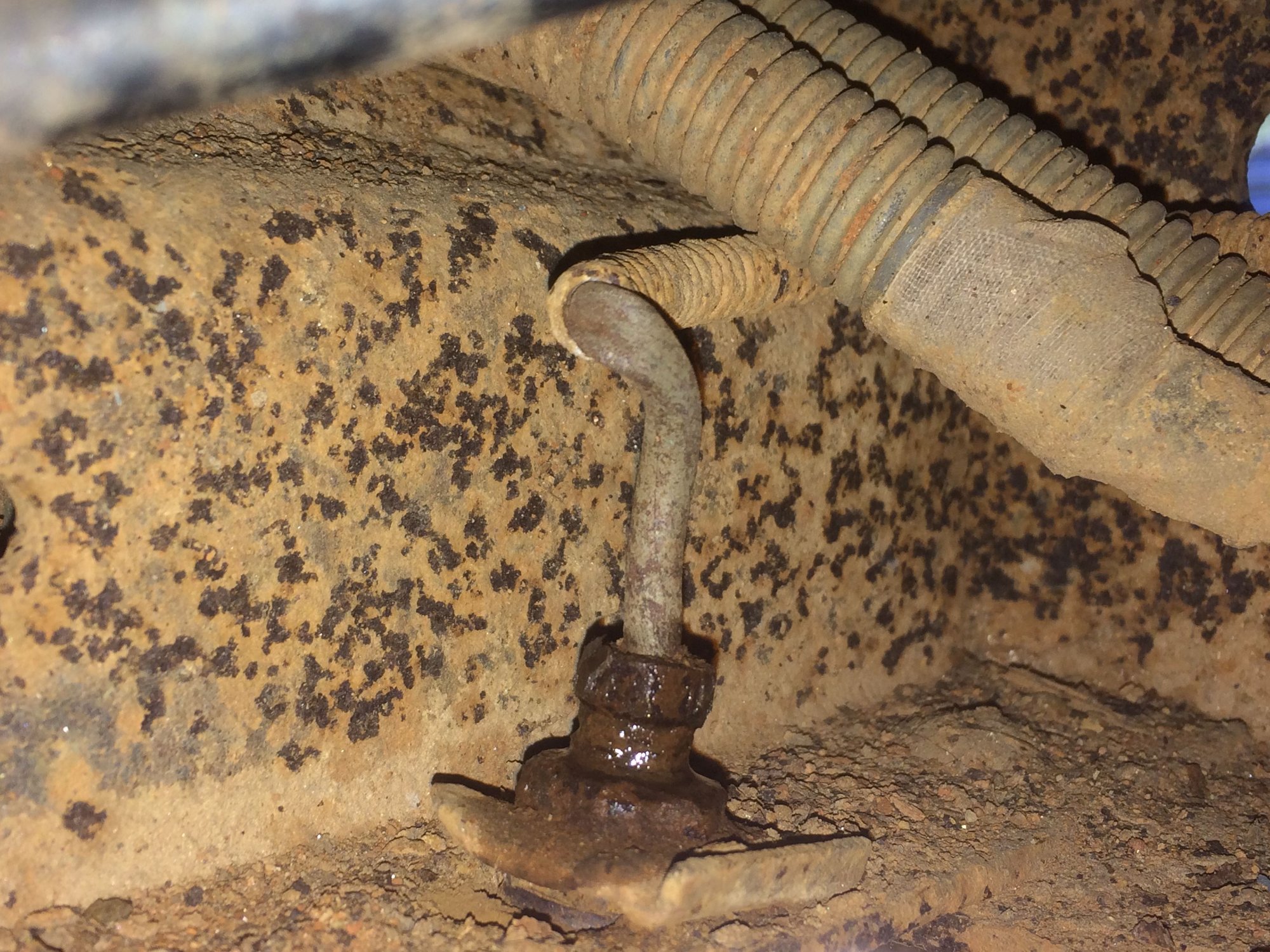

I was attempting to replace my rear axle brake lines and when I tried to unscrew I realized the whole line was twisting and therefore the main line from the booster to the rear axle was twisted. I need to replace it, but cannot find one online. Is that called the main chassis line? I found some of those for earlier Bronco's, but not mine. Where can I find this piece?

I am replacing all rubber lines with braided steel and the two rear axle lines (because of a kink). Bronco Graveyard shipped them in a large cardboard tube and thankfully they weren't bent.
I have a cutter and flaring tool, but it does not have those other 5 pieces. Will I need those? It only twisted about 3" of tube so if a bend could be made it may still fit, but I am not sure how to bend it without kinking.
What size is the average brake line and would I measure OD or ID?
I will upload a pic in a second.

Old Nov 13, 2016 | 02:33 PM

Most brake line is 3/16".
You definitely need to make a double flare, and you can't do that without those little anvils.
If it were me, and I didn't have the tools, I would just buy enough sections of line -and couplers- to replace it. (You really don't want to know what it looks like up between the side tank and the frame rail)
​​​​​​​Like two 6' and whatever the last bit needs to be.
Tube benders come in a few styles...
Slip over springs for freehand bending.
Ones that look like a pair of bolt cutters with a protractor, for when knowing the degree of bend is important.
Small single lever ones that have a spindle and hook appropriate for the size line you're bending. (this is most common)
You can also buy the nicopp brake lines and just bend them by hand, or around almost anything radiused.
​​​​​​​A little more costly but easy to work with and they will not rot out.

Wouldn't I still need to bend the sections of tubing as well? Also, how will I get the female coupler on the ends I would connect?
I was thinking I could pull the entire line and pre make the bends before installing comparing it to the original, but now that I am thinking about it, I may have trouble getting it back in that way.
Also, I do not have a side fuel tank. I can follow the brake line all the way to the booster.
I see where you mentioned the niccop lines above ArdWrkn. I missed that before.
My AZ may rent out a flaring tool and bender.
