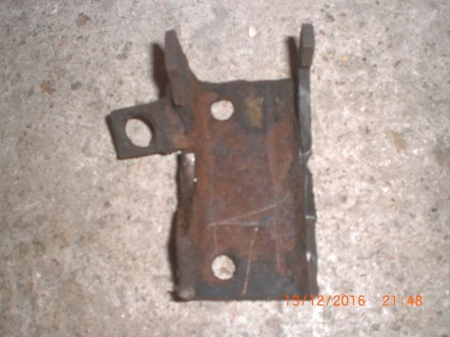

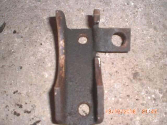

My driver side bracket look the same, the hole in the tab fit over a cast nipple on the housing to prevent the bracket from turning.
Marc
driver side,
passenger side

Interesting yours seems to have the same hack job as mine does. Interesting bit about the hole fitting over a cast. I didn't notice that when I took it apart.
