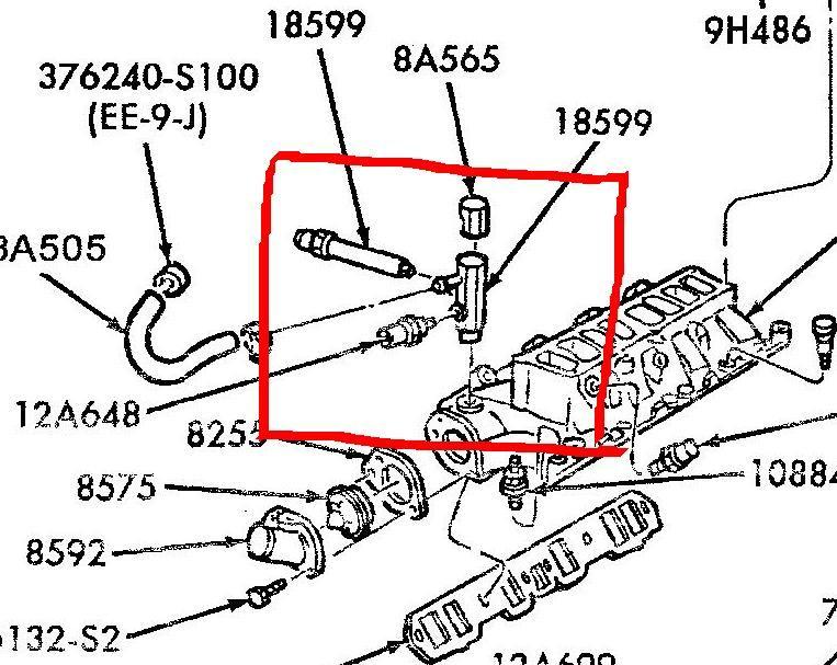

does anyone have an aftermarket replacement source or at lease a full motorcraft part number for parts 8A565 and 18599? mine is leaking, and i'm not even sure what it's really called. Truck is a 1990 F-150 with a 5.0.

There are no Motorcraft part numbers, just Ford part numbers for these two parts.
E7TZ-8A565-A .. Shield-Water Outlet Connection / Obsolete ~ 5 available NOS
Applications: 1987/96 E/F150 & Bronco 5.0L
The 18599 pipe .. is it threaded on one or both ends?
These are a b!tch to look up in the catalog, as the pics never match and their descriptions are wanting.
