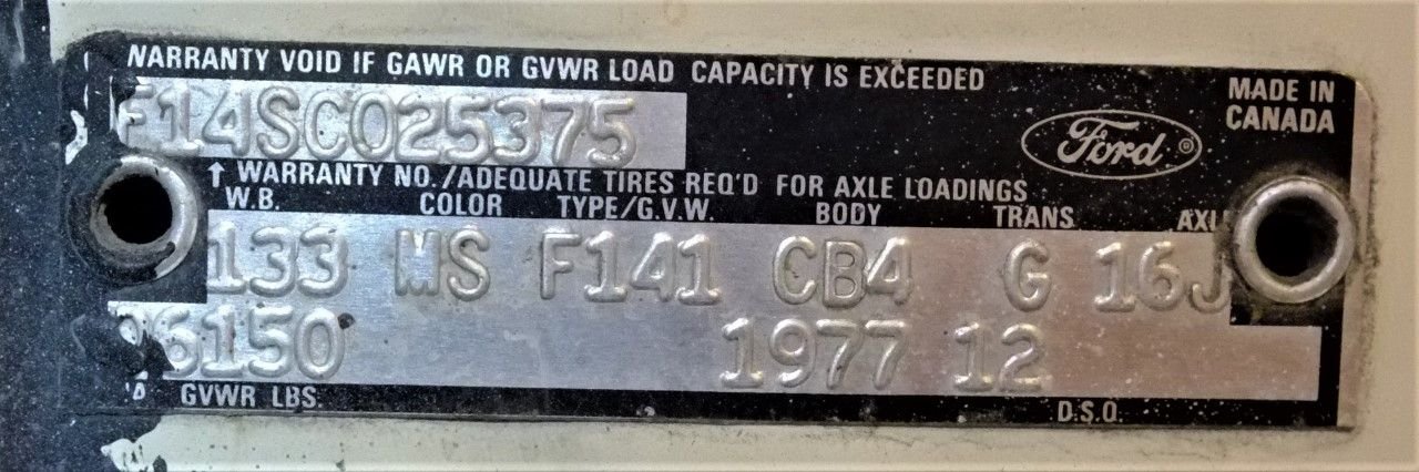

Does it matter if the Truck were made in the Ontario Plant, Canada or are
the Serial Numbers for all Plants? Mine have #25375.

According to the OP's truck Warranty Plate pictured in post #1, truck assembled in Oakville Ontario Canada and ordered from the Buffalo NY Ford District Sales Office (DSO: 12).
So is it an F100 or an F150? I see 14 in the VIN, but also the GVW of 6150 lbs. That's higher than my 150, which says 6050 lbs.
F14 = F150 4WD .. No F100 4WD's after 1976.
F150 4WD's have a higher GVWR than 2WD's.
