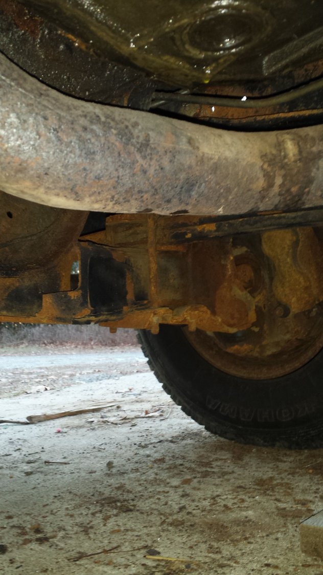

My 97' F-250 5.8 has a coolant leak presen at what appears to be just above the transmissionand behind the engine (passenger's side). It only leak while, or after I have driven, and not while idling. It almost looks like the cooland is from the transmission bit it is running down the side of it from above. Any idea's?

Intake gasket, head gasket, freeze plugs. I'm not too familiar with the windsor blocks, so I don't know if any coolant hoses run around back there. But those three are pretty universal to all V8's.

Clean it all up and put a pressure test on it to spot the leak. You can rent a kit from a parts store.
I had a similar leak, it was a freeze plug near a motor mount.
