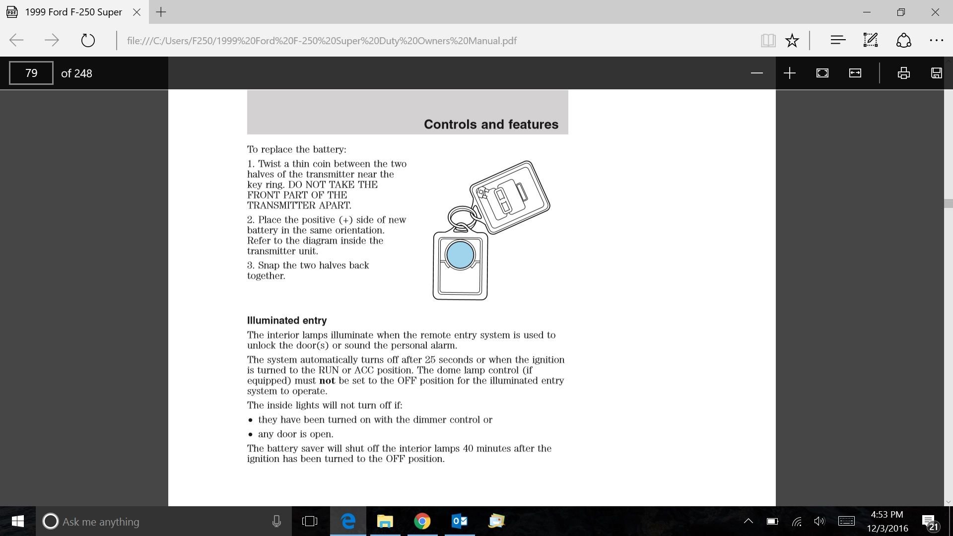

They stay on for a few minutes after you get out of the truck, if that's what you are talking about. There is a delay, before they shut off.

there is a delay but they r staying on for awhile then they go off

This may help.
