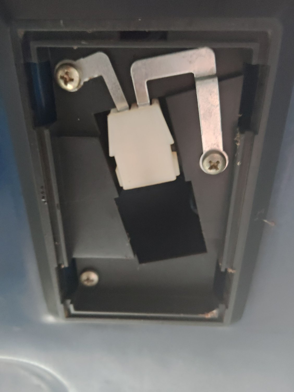

Any words of wisdom on how to remove the J shaped plastic (green and blue) wire ends that the bolts on the courtesy light screw into? Mine were cracked already (assume the light was tightened too much or the PO had tried to remove them before me) so I am wanting to solder some good ends to mine but I have no clue how to release them so they swing down and come out.

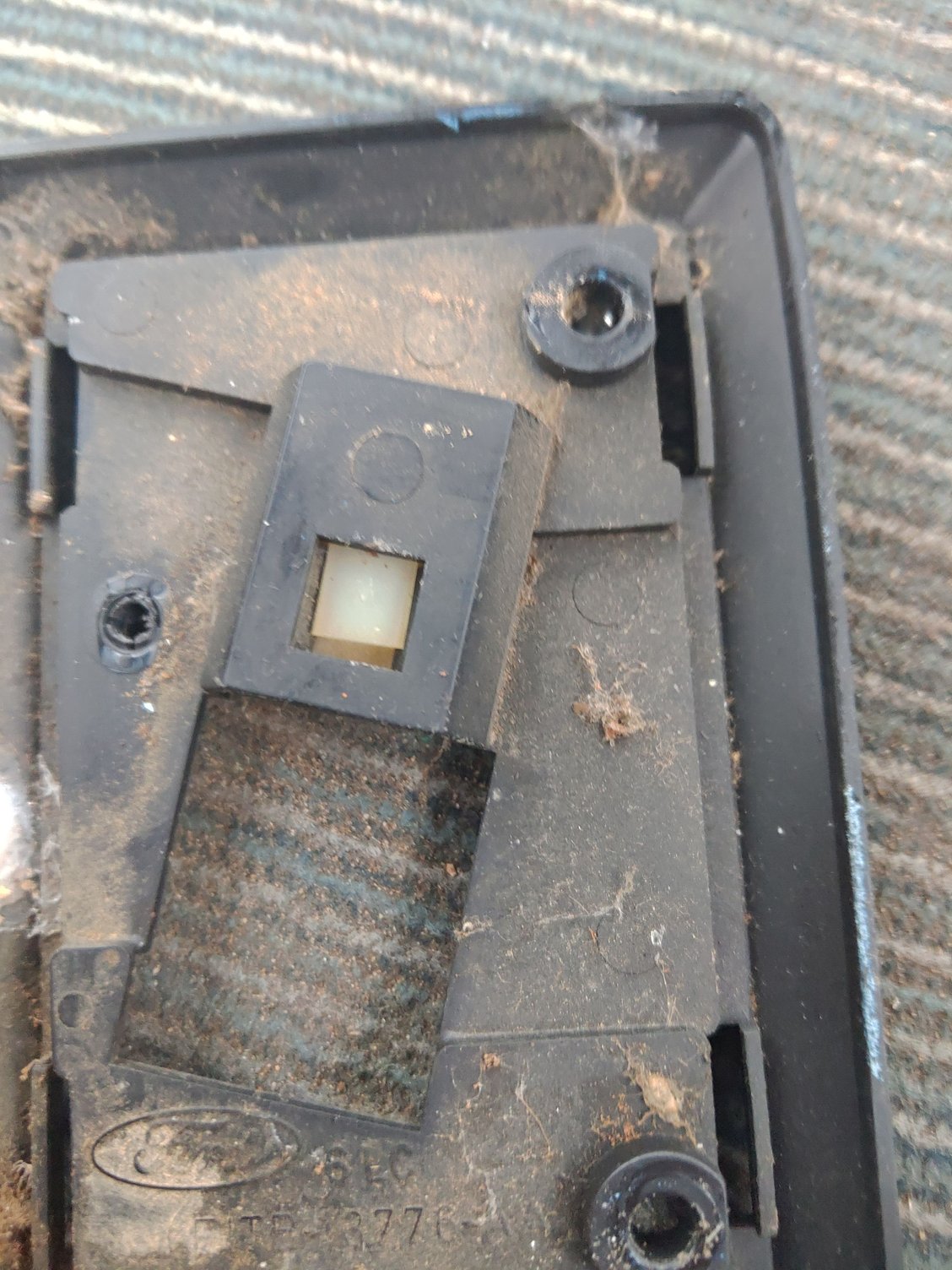

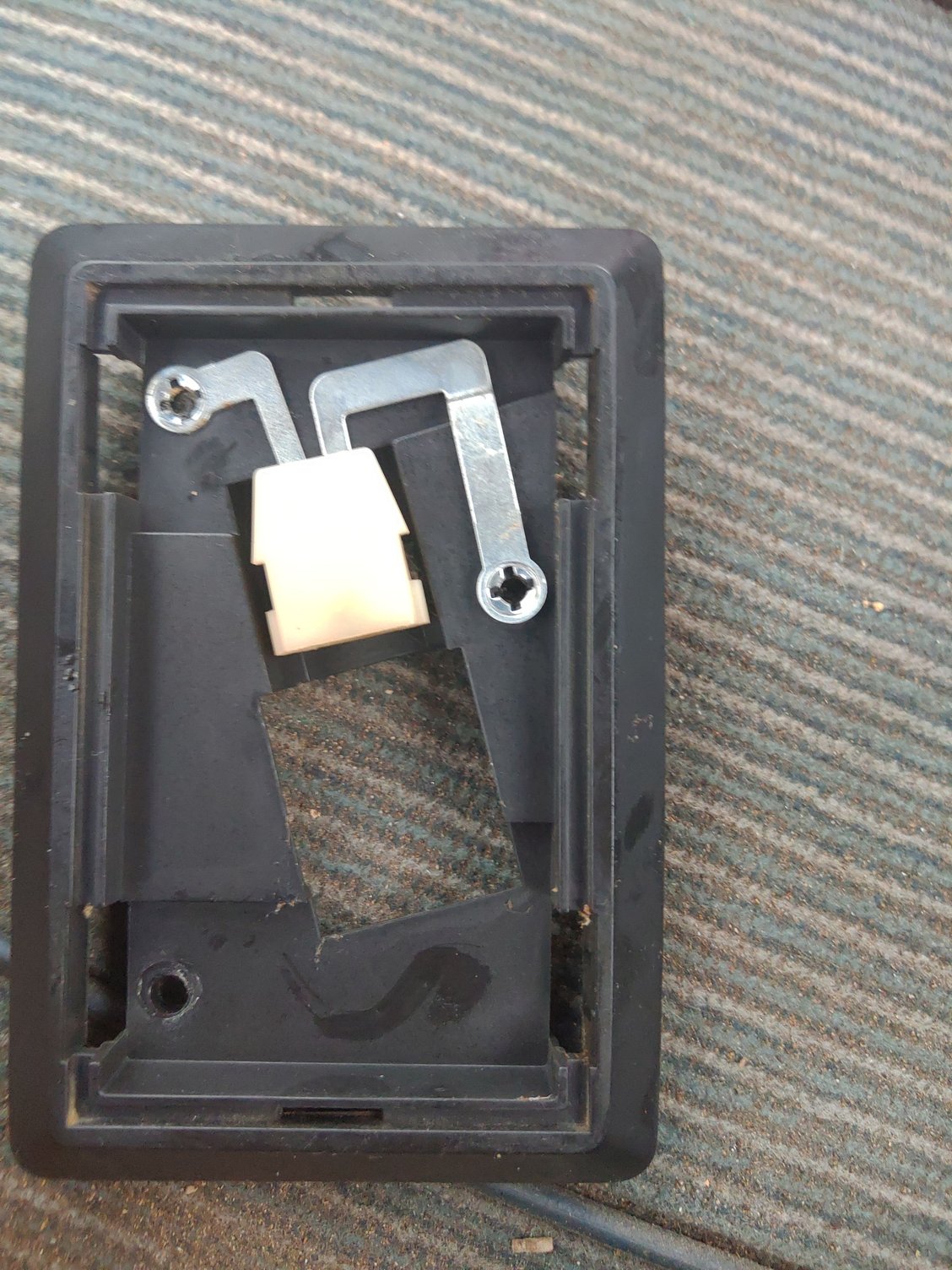

What does your setup look like, got some pictures? The courtesy like the same as the dome light? I just went out and took the dome light apart in my donor truck, it's an '85 F150. Pics of what I'm working with:
If you're are anything like this, there is a detent tab on one side. Mine came right out(no longer detenting).

Hey,
Yeah, I am talking about that end terminal/clip in your 4th and 5th photos. I see you have a good size hole to feel around in and press the detent (if it was still hooking). On my supercab there is a really small hole that I couldn't even get a pick angled the right way in. My plan at the moment is to go to the jy and cut the sheet around the dome light, pull them out backwards, solder to mine, install and hope I never have to take them out again.
Thanks a lot for the photos, they help get an idea of how the piece looks.

Hit them from the face side, go in right next to the connector, only the one detent. Should be enough slop in the hole to get in there with a pick. Or take an aluminum can and cut a sliver out of it and push it down next to the connector and rock it out. may have to fold the aluminum in half to make it a bit stiffer. Have used that method to open and reuse the aluminum security seals that are made like zip ties.
