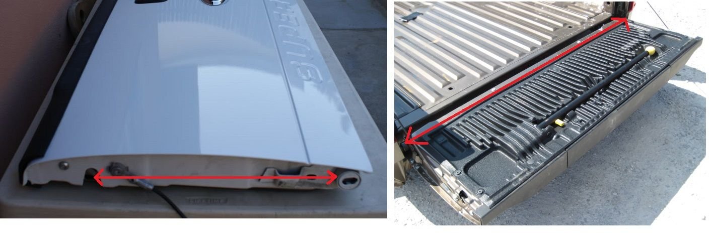

Measure the width of the tailgate, also measure at the hinge from one side to the other, then measure from top to bottom as well as the hinge to the latch on the side of the tailgate.
Hope this makes sense.
You may run into a problem at the sides of the tailgate where the 08 to 16 gate has a slight curve on each side, where as the 2017 gate appears to be straight on the sides.
I'm thinking it most likely won't work, may be worth a try though.
