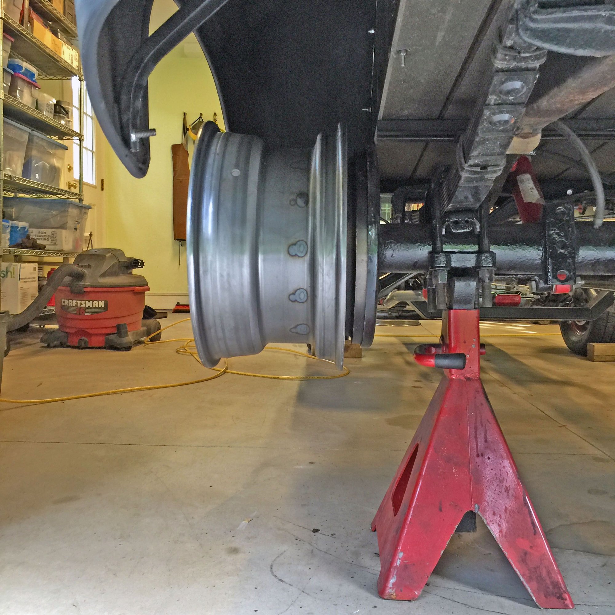

Last year's Christmas present
The Baumann controller can be added later. Just make sure that your rear wheels are off the ground on solid jack stands before you run through the gears.
