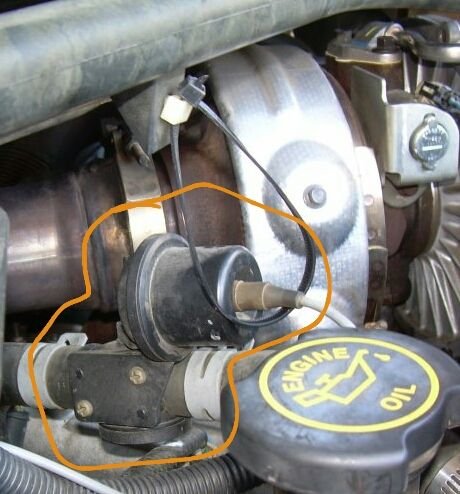

Did you try un hooking BOTH heater hoses and running water through just the heater core? Do a reverse flush on it with a garden hose and see what comes out.

Us the heater valve actually working, the one installed in the hose and you applied vacuum to it for the test?

I didn't see a valve in the hose. Where is it?

Here's the valve. By default (no vacuum applied) it will allow coolant to pass.
After the coolant temp is up, feel the 2 rubber hoses coming from the core to see if they're hot showing circulation.

Well, that's odd. I don't have one of those!

Are the heater hoses feeding the core at least hot?
