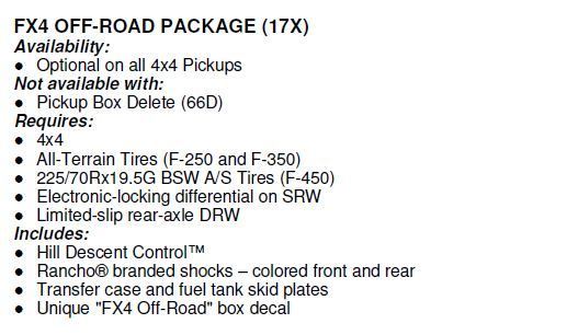

I placed an order on Oct 28. F-350 DRW Platinum. I requested the 3.55 rear end. When I added the off road package the dealer said the 3.55 was no longer an option and had to be switched to 4.10. I was not happy but accepted it because I liked the skid plates and the hill descent. I now see platinums on the lot with off road option AND the 3.55. Not happy but it will work since I will be pulling 19/20K fifth wheel.

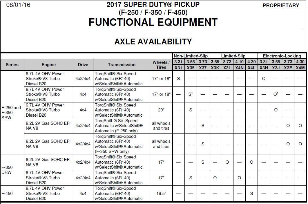

Not sure where they got that from. The order guide clearly shows it as an option.

Rasalas thanks. I saw that this morning. My dealer did not use a form. He used a Ford software program to pick options. I picked the 3.55 axle. Several options later the off road package came up. I said yes. The program stated off road package not available with 3.55 axle. After a short discussion I chose the 4.10 with the off road package.
I had time to think about it overnight. I figured the 4.10 would pull like a champ in the mountains, but it just won't get the fuel mileage when unloaded. I like playing the fuel mileage game as a daily driver. Fuel price is not an issue. I don't like to see high rpm when running 75-80 mph. And also like playing with the transmission when in the mountains. Oh well, I keep telling myself.... It will be OK. This Diesel engine is going to last forever.

With the tires on the F350 DRW (645 Revs / mile per Ford), personally, I'd strongly prefer the 4.10. The DRW 3.55 has it's worst pulling speed at just over 65 MPH - right where I pull the big mountains. At 70 MPH, you are 3000 RPMs in 3rd (too high) and 2200 in 4th (too low for full power - around 360 HP vs 440 HP at 2800). Chances are your transmission will be in 5th pulling at 65 MPH, which is a suboptimal 2100 RPMs.
The 4.10 is just right for this 65-70 MPH roads. 2600 RPM at 70 MPH in 5th, and you can still accelerate to 75 MPH to pass in 5th before passing 2800 RPMs.
If you pull the mountains below 65 MPH, the 3.55 is great. It really depends on how you want to drive. I hope this helps you feel better about your 4.10 if you're stuck with it. (It'll shift a lot less towing as well.)

3.31 vs 3.55
Aren't most of the people running 3.31 on 275/70/18 tires with a diameter of 33.2". And 3.55 run 275/65/20 with a diameter of 34.1"
The net result should be about the same RPM's and gas mileage should it not. I don't see why 3.55 is automatically better for towing without taking into consideration the tire diameter. Also for mileage purposes it would be helpful to disclose both ratio and tire size.
This was discussed earlier in the thread.
Most that I know that tow heavy get the 18's tires and 3.55. Not only are the tires cheaper to replace (and they don't last long if towing heavy) but you actually have a 3.55. 20's and 3.55 effectively gives you 3.32. The advantages to the 20's are slightly higher capacity and better looks.

I did see the earlier post, however it did not discuss all of the tire options. Are people towing heavy loads running 275 65 18 or 275 70 18?
The smaller one is the AS ratio and de-rates the axle to 6780# if you select it.
