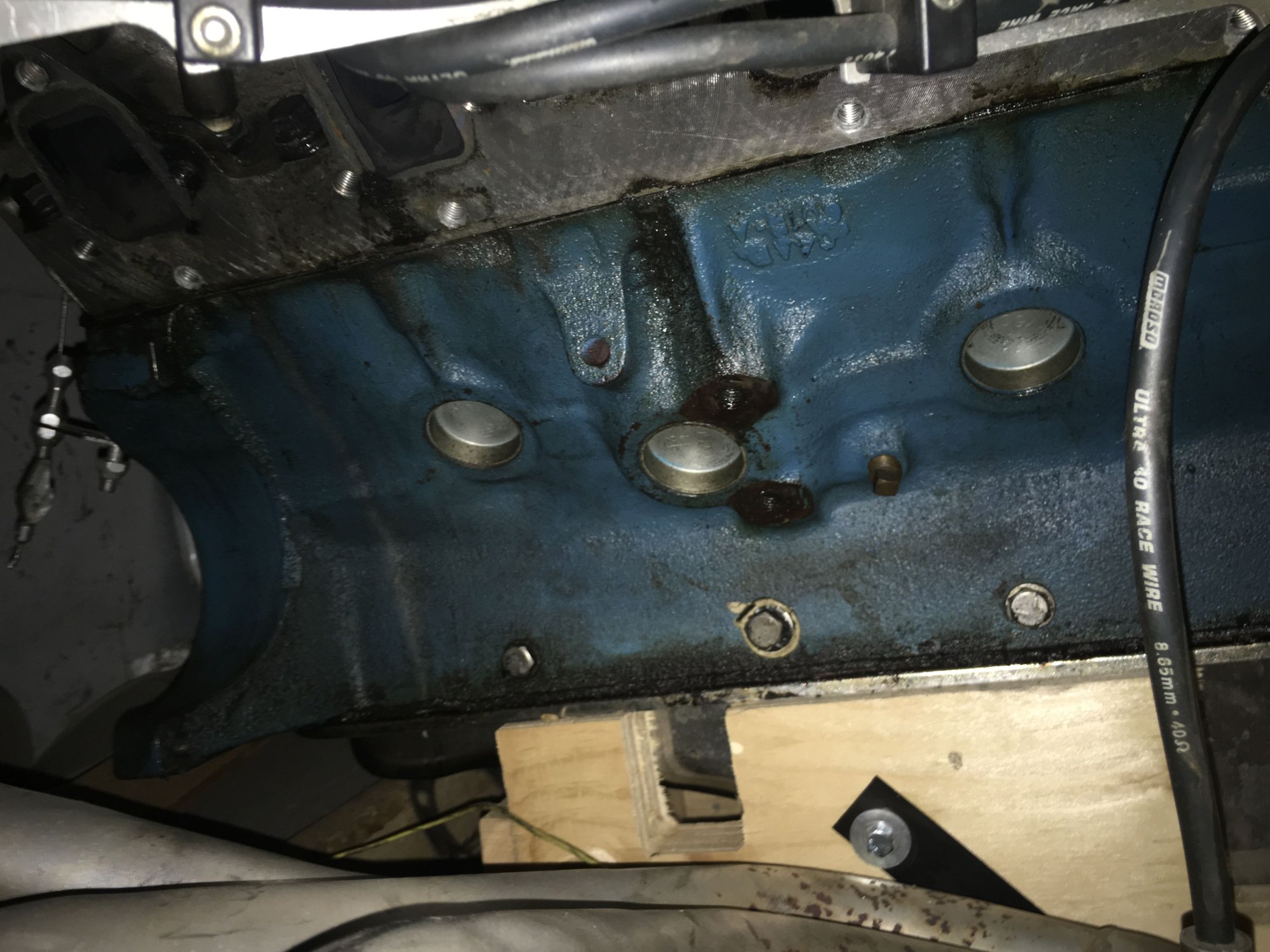

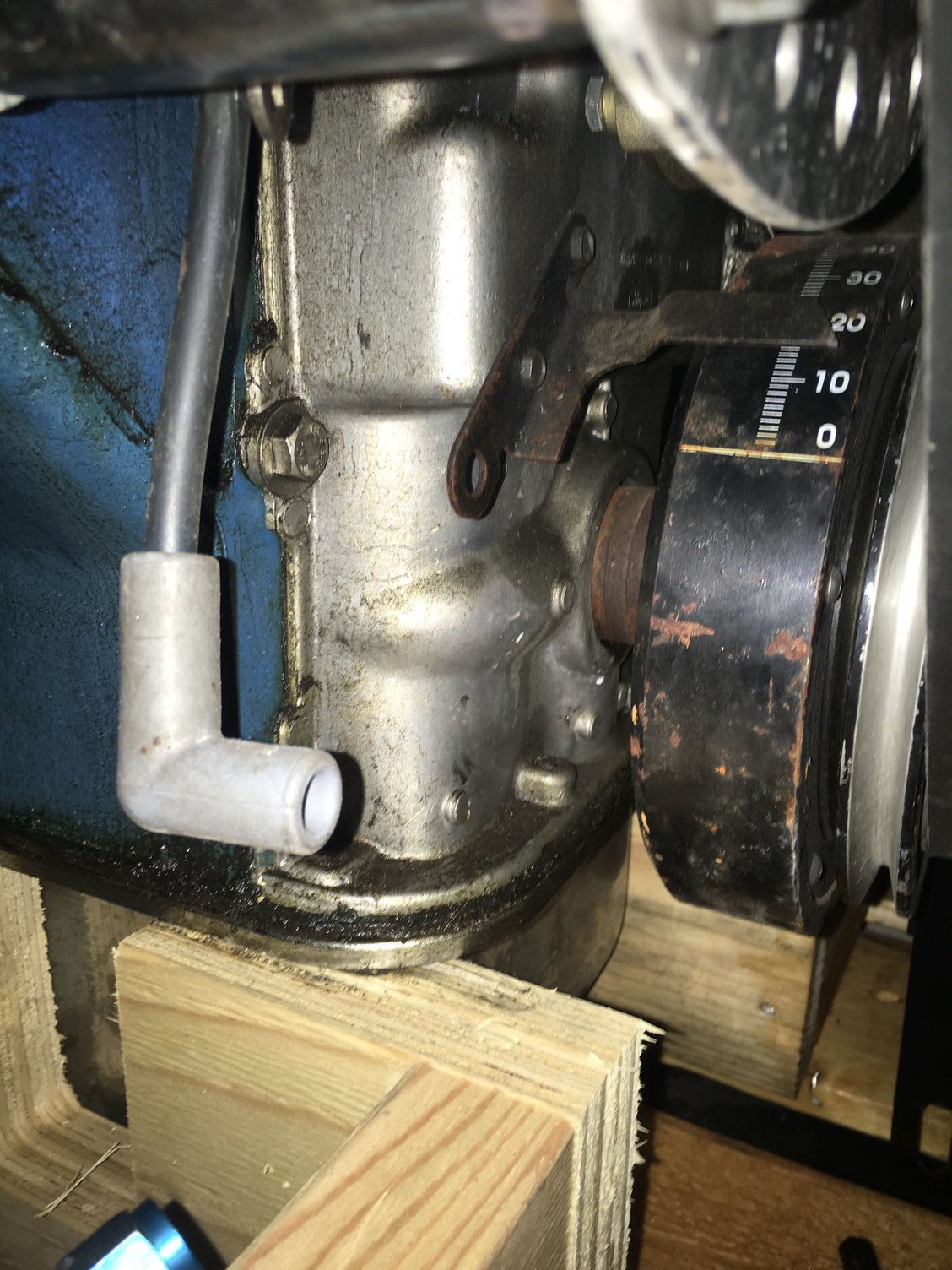

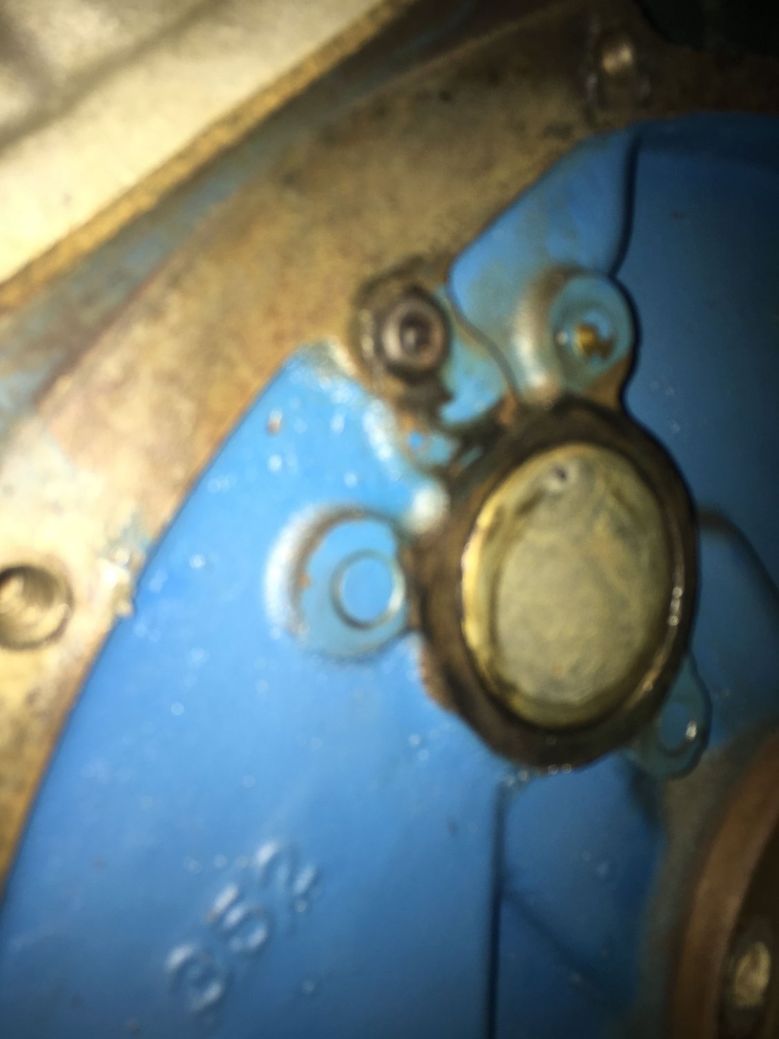

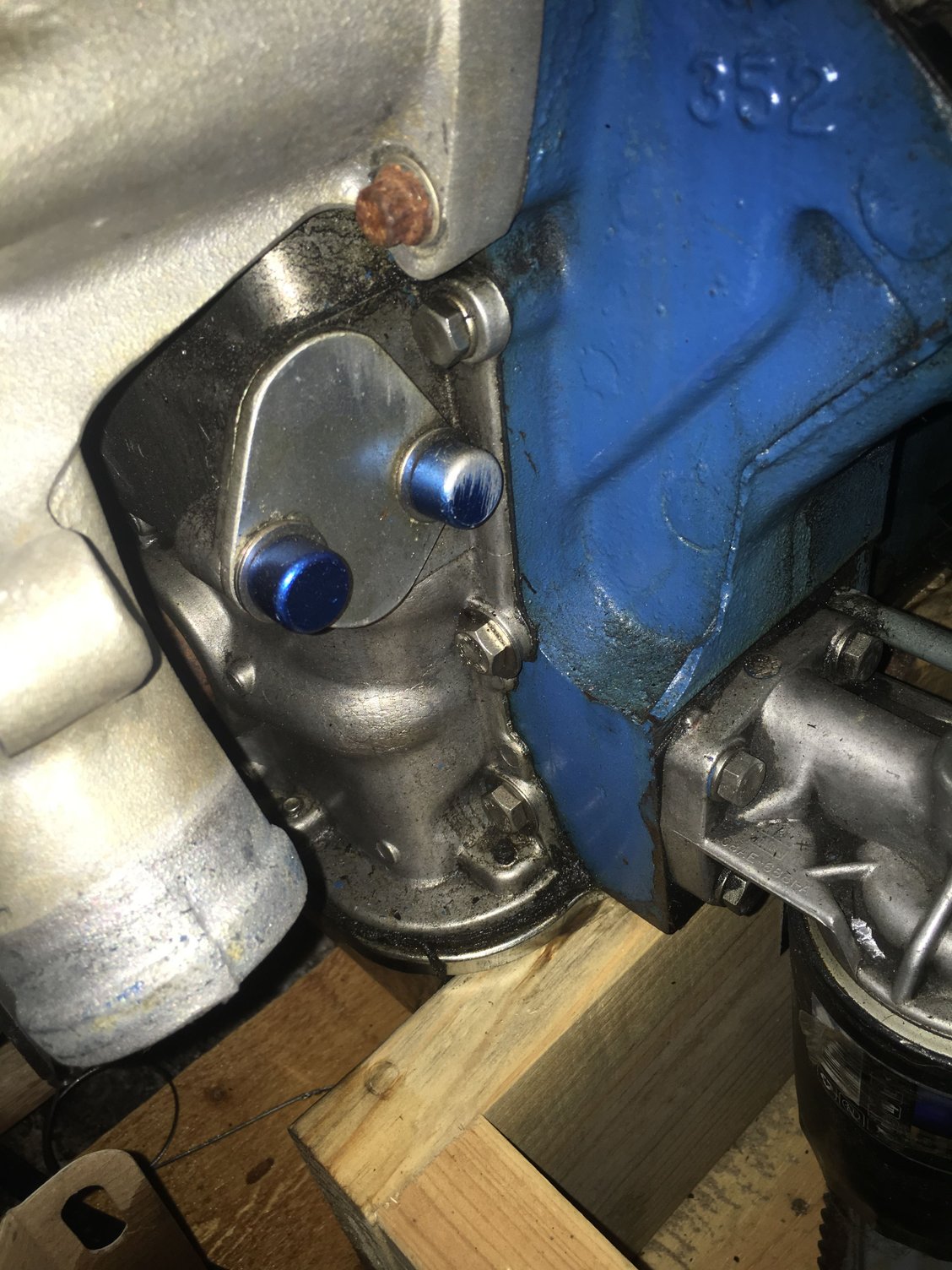

Bought a 427 need help

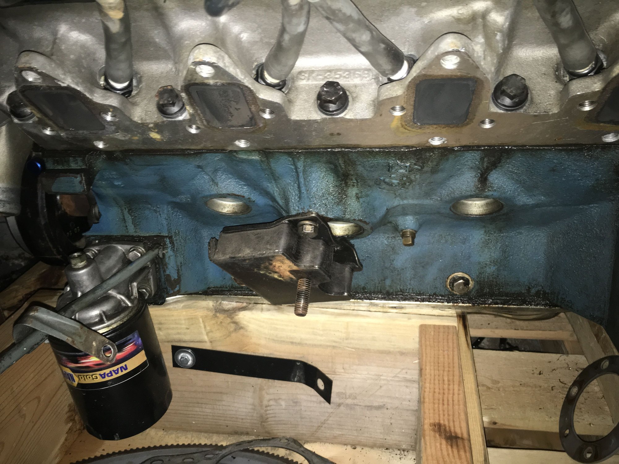

there is no casting numbers on the engine online found D1F and 2 was under neath it
i found that by the oil filter I think
14 352 another number

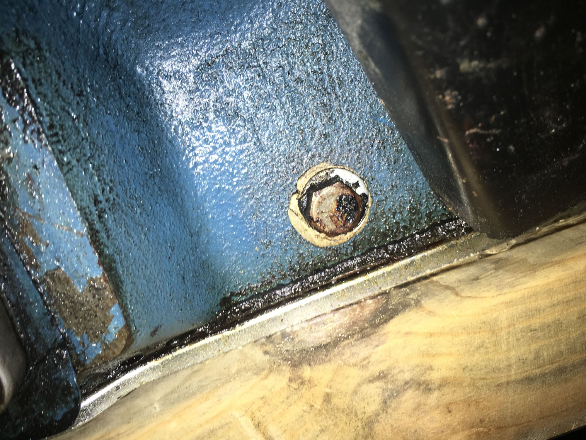

engine is not stock punched out, sk 35369 heads forgot the intake but not stock anyways
it has cross bolt mains
How do I tell if it's a side oiler or top oiler?
here are some pictures

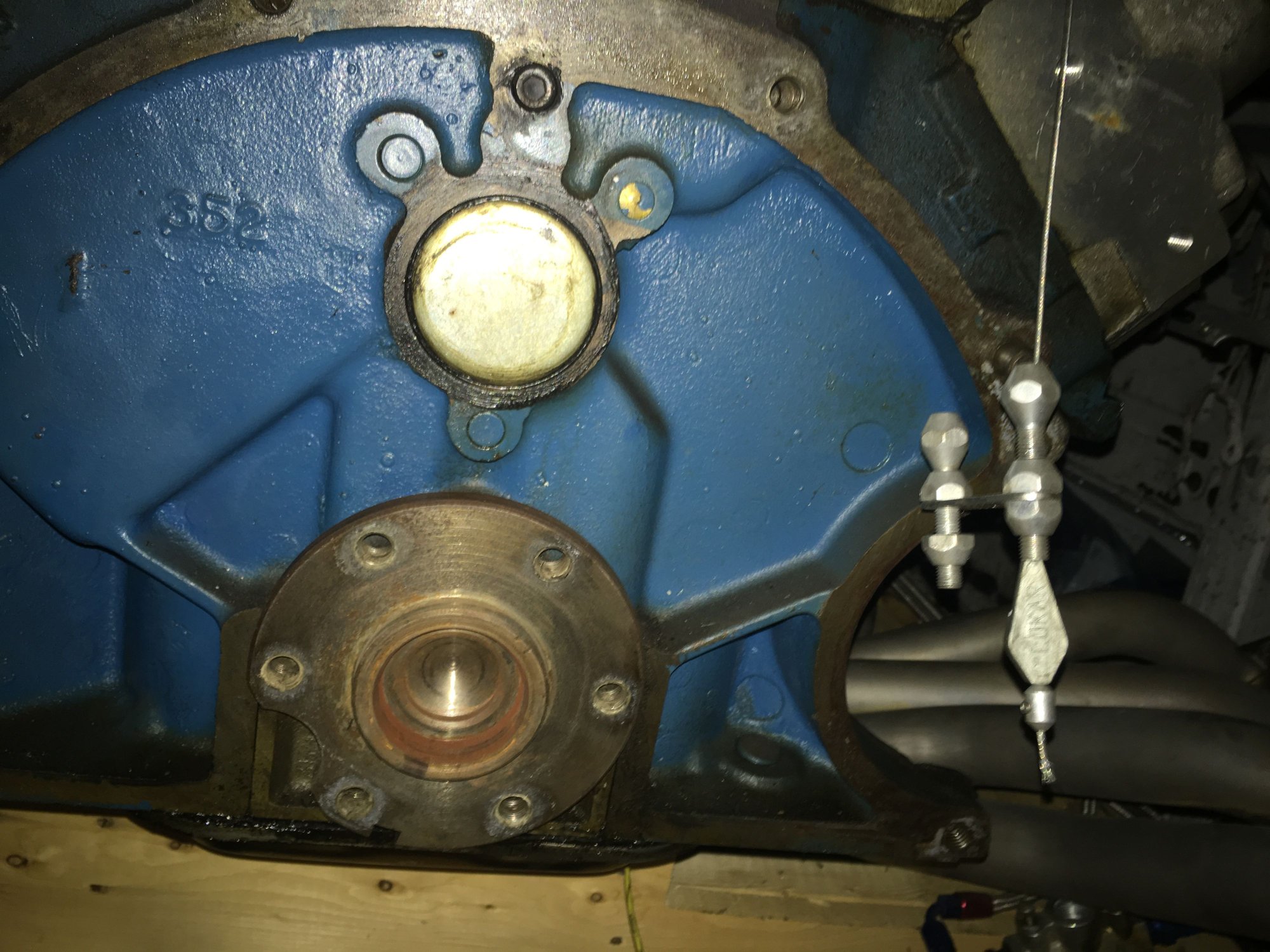

Can you read the casting number on it? (Your 5th picture) Look for a C2.. or C3.. or C4 etc number. You block doesn't appear to be a side oiler. It has only two motor mount bolt holes and no screw-in freeze plugs and no bulge on the driver side. It may be an earlier engine.

Looks to be C4AE-6015-A
Comes up as galaxie 427?

All I can say is it ain't a sideoiler...no side oil galley on the oil filter side. For more info you may have to visit one of the FE forums where all the FE nuts hang out.

Not a sideoiler for sure.
*May* also be any FE where someone added crossbolts.
Of course someone adding SK heads sure sets it apart from the common FE engine. I hate to say it, but the only way you are going to know what this engine is, is to dig a little deeper into the engine.

Why do the crossbolts look like Grade 5 (not 8) ?

They don't need to be grade 8.

I was saying, you have a C4AE block (all of them came with crossbolt provisions that year, so anyone could easily add crossbolts), there are no screw in plugs, you *think* it's a 427.
So buy the gaskets and pull a head.
Chances are you do not have a 427, but you may..... only one way to REALLY find out, pull a head.
