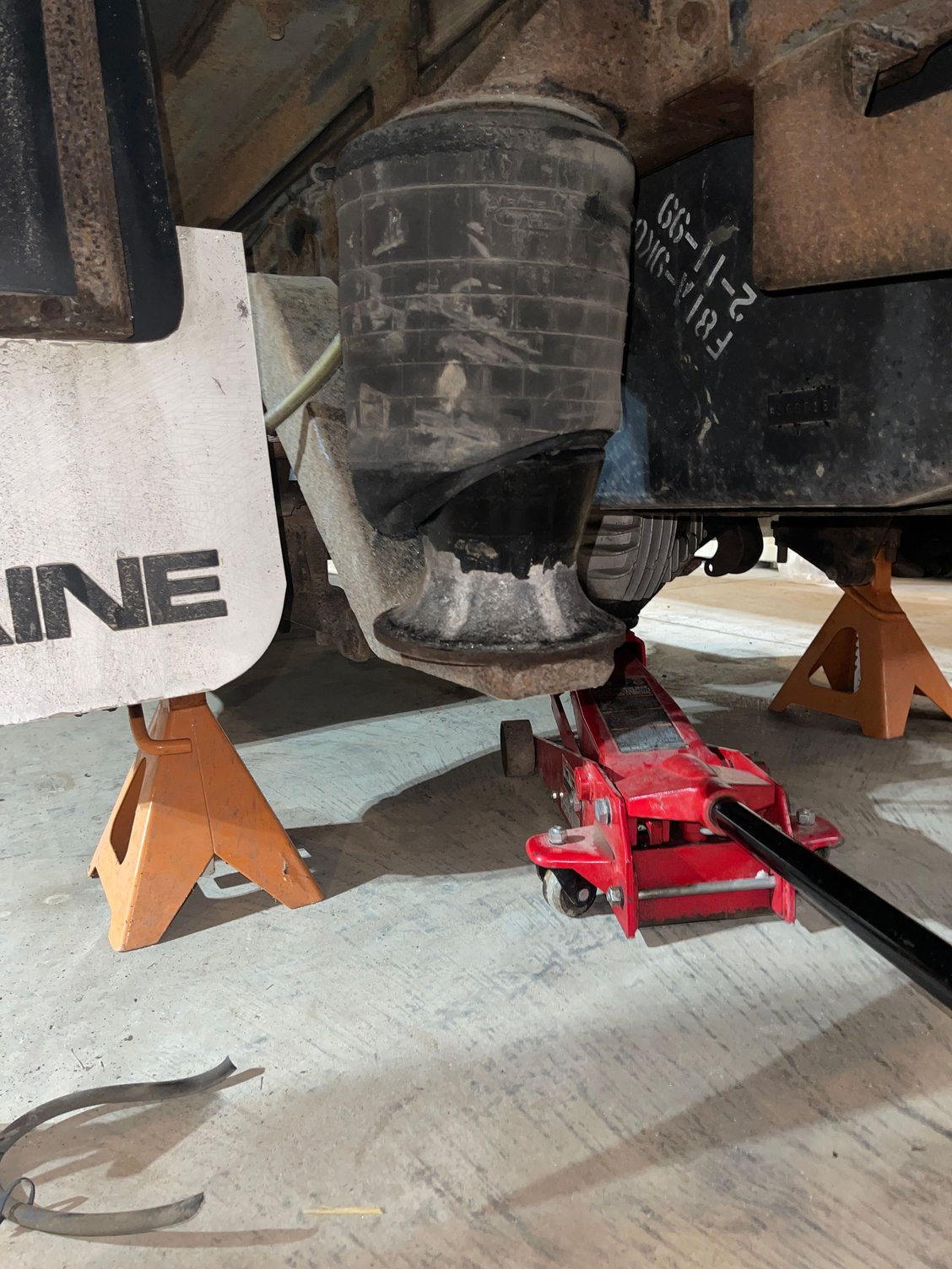

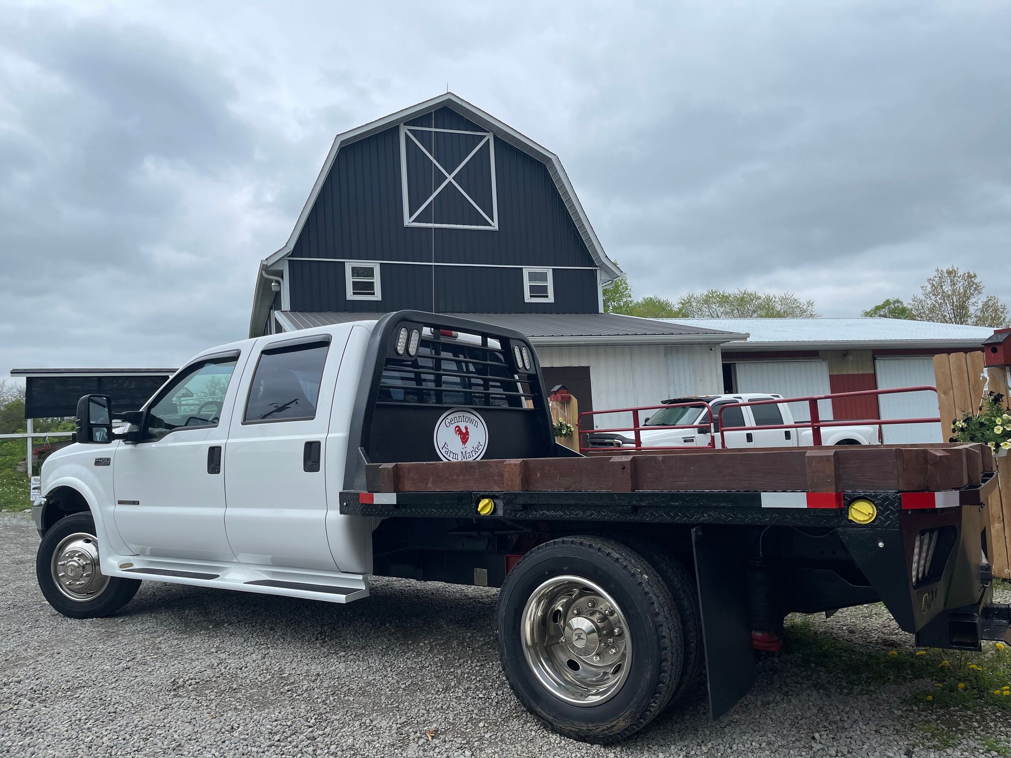

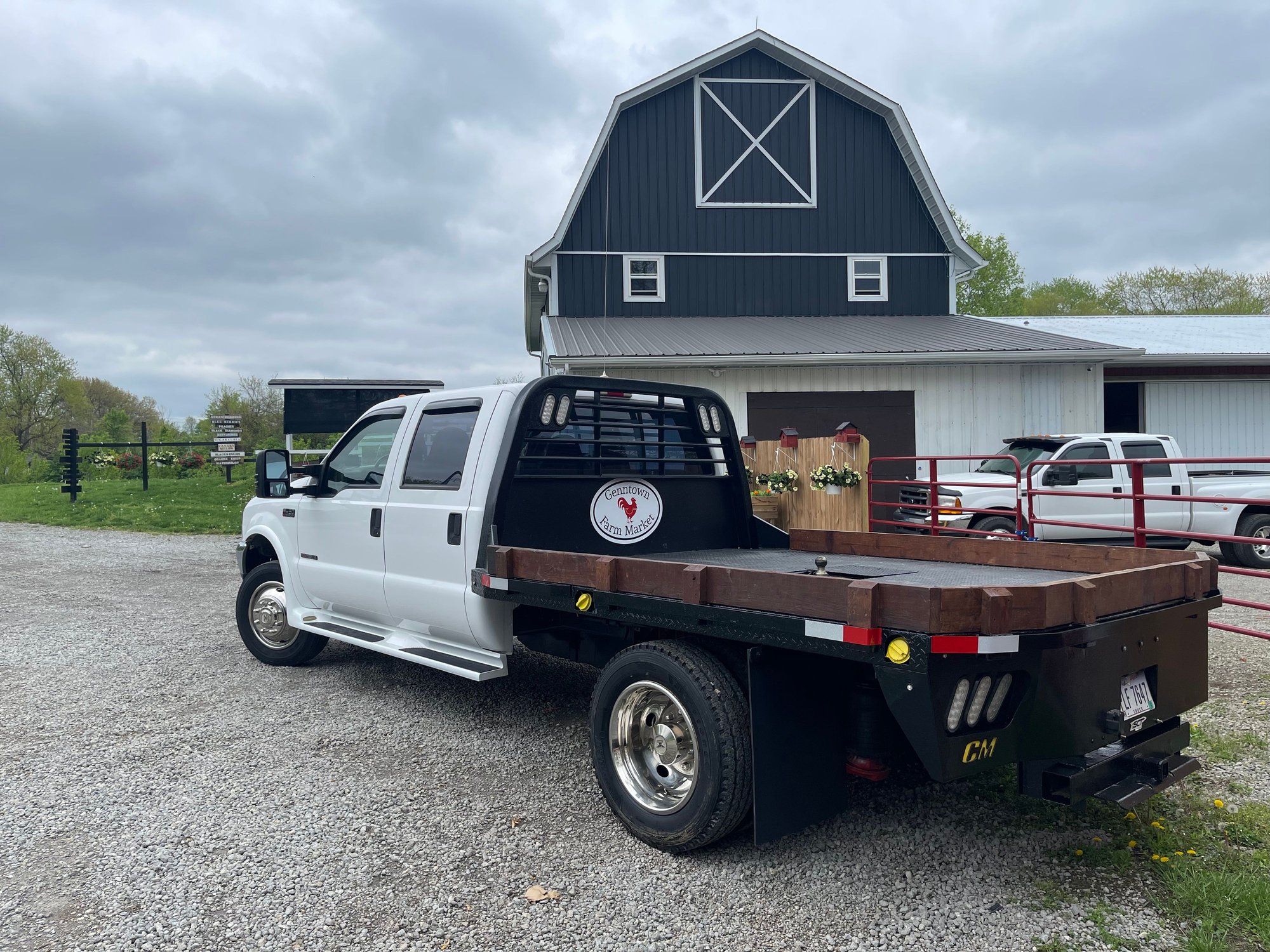

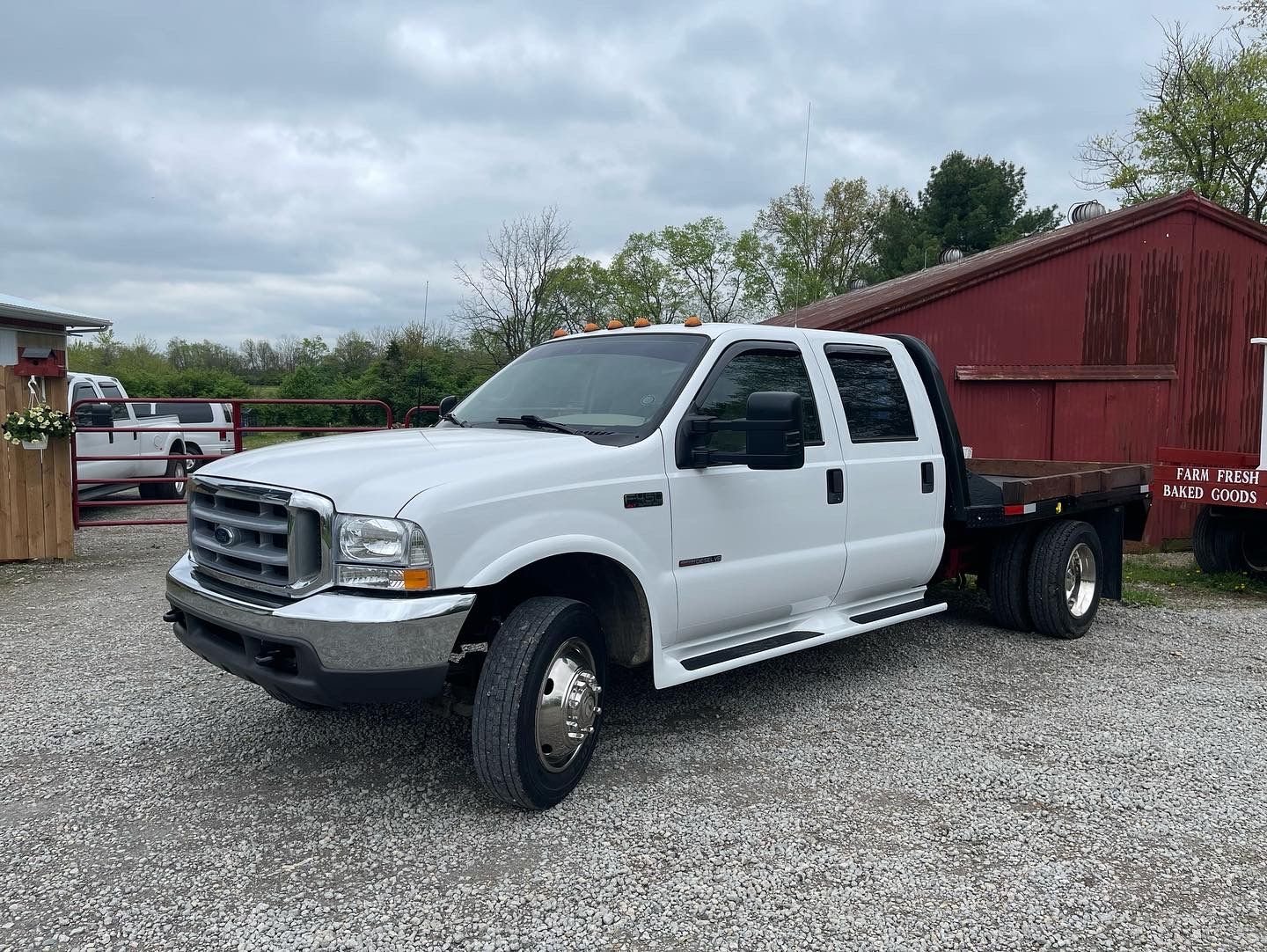

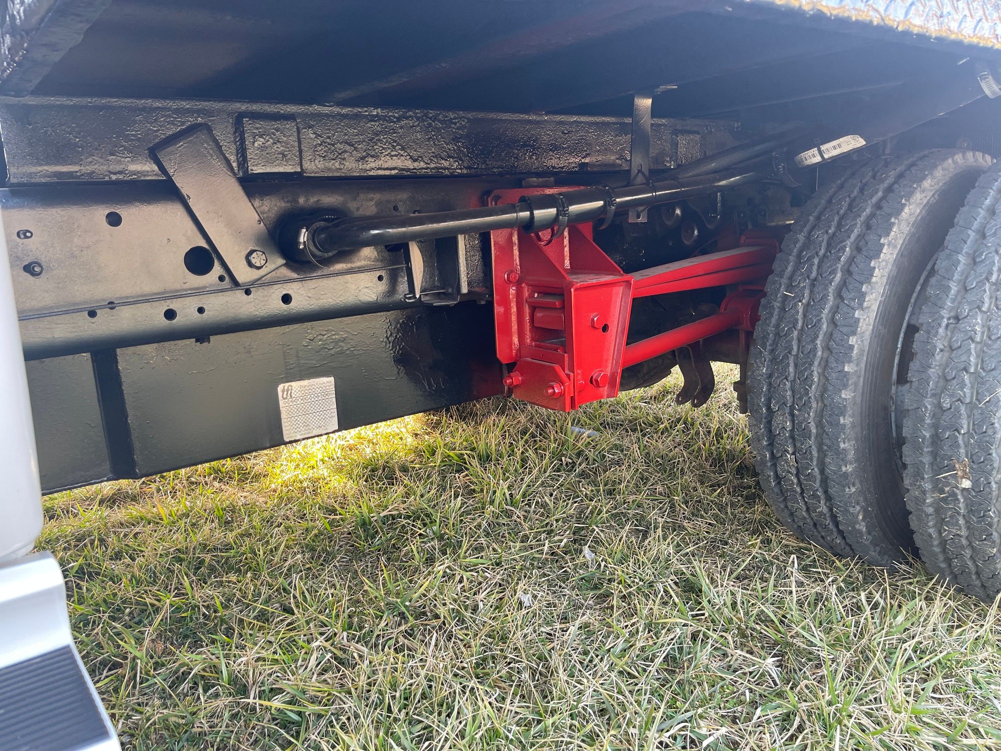

This is how it sits currently… I’ve owned it about 8 months and replaced the rear air springs and put the flatbed on..
Before.
Before.
Before replacing the bags and painted the frame
Before.
Before.
ance
what replacement air bags did you go with? Mine are getting weather cracked and wanna replace them but having a had time, we deal with air bags all the time at work but this ones proving tricky.
