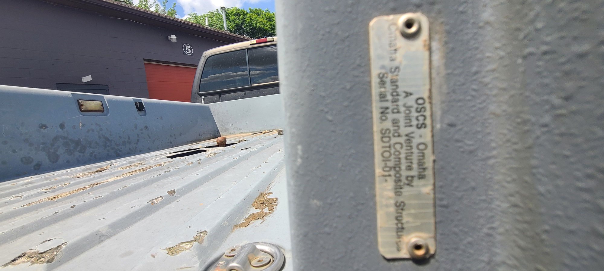

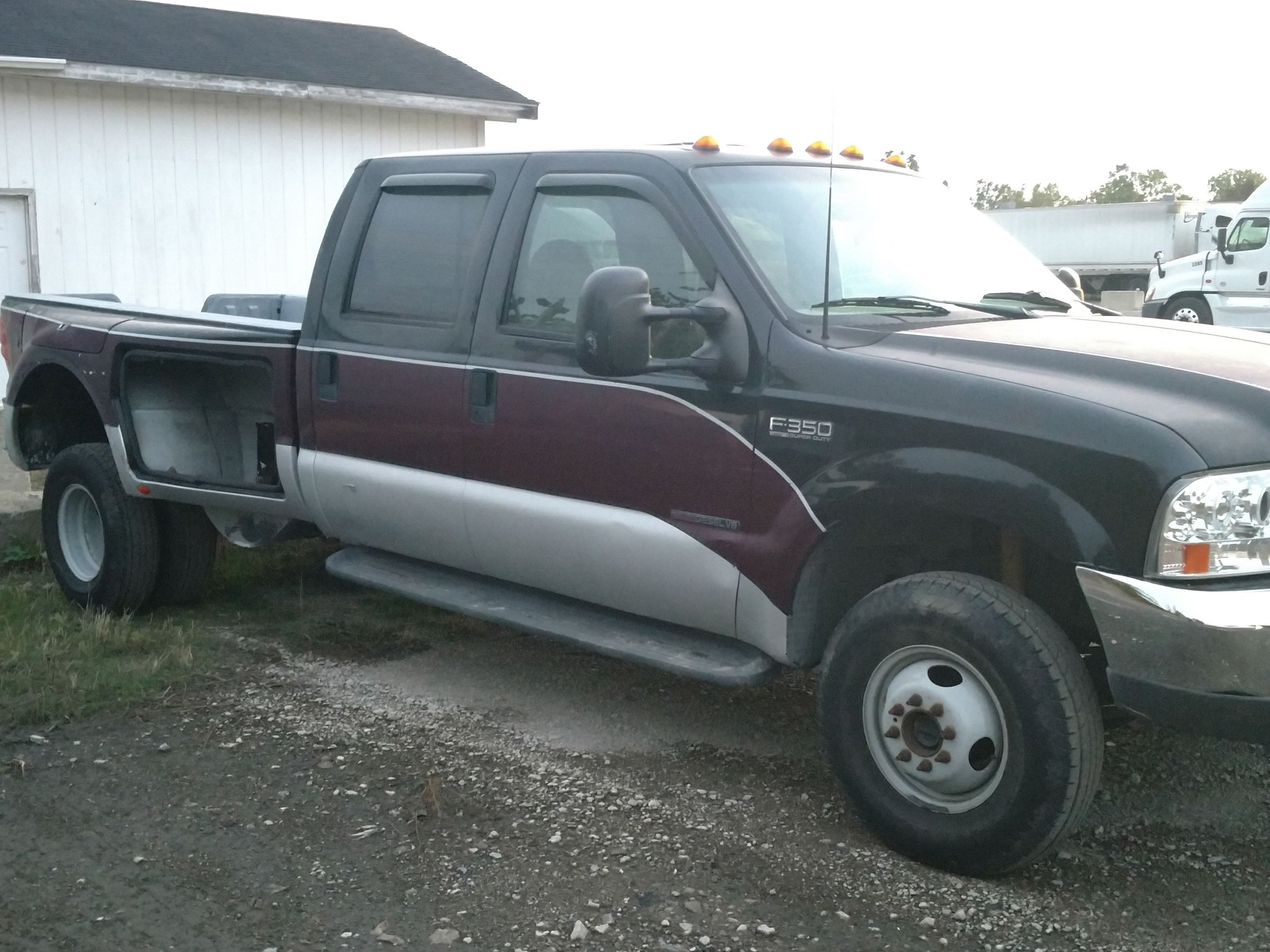

Am I
Am I in the right place for questions about this bed? Was the closest thing found via Google. I need to replace a missing door. Don't judge me, it's a recent procurement and came as is.

OMG, I've been looking for that bed for 20 years! Well not actively looking... but I haven't seen it in 20 years.
It is not a Fontaine, and it has nothing to do with the Classic Traveler.
I met with one of the folks behind the creation of that bed when they came out to CA for a meeting on a different truck related something or other.
I have always wanted to understand why that bed didn't take off like gangbusters. Conceptually, it hit a lot of hot buttons in unique ways that no other bed before or since has managed to hit in one offering. Conceptually, that is. In practical use, however, I wondered. That's why I've been sort of looking for it for the last 20 years. The last time I saw a photo of that bed, it was in 2003. Harvest Gold color.
You are more than welcome to post more photos of it, and discuss it. We can leave it all here in this topic for now, to pull in people who are already subscribed. Anyone interested in the Fontaine will surely be mildly interested in this unique blend of the Royal Sport sculpted utility body concept with the lower rail height SuperCrewZer II concept (which eventually became the Classic Traveler).
if interest takes off, we can move it all over to a new thread. Thanks for posting!

Wow, that was way ahead of it's time, makes use of a lot of dead space! If @Y2KW57 hasn't seen one for 20 years, I wouldn't hold out much luck for finding any parts......he has been a godsend to me with information about the Fontaine stuff & a wealth of knowledge about the history of these trucks.
I'd suggest contacting a company that makes fibreglass molds as I think that will be your best route. Do you have the broken door? If so it could be stuck back together to take a mold from, if not then it's going to mean some work & skills to make a template....
We do need more pictures & history though!

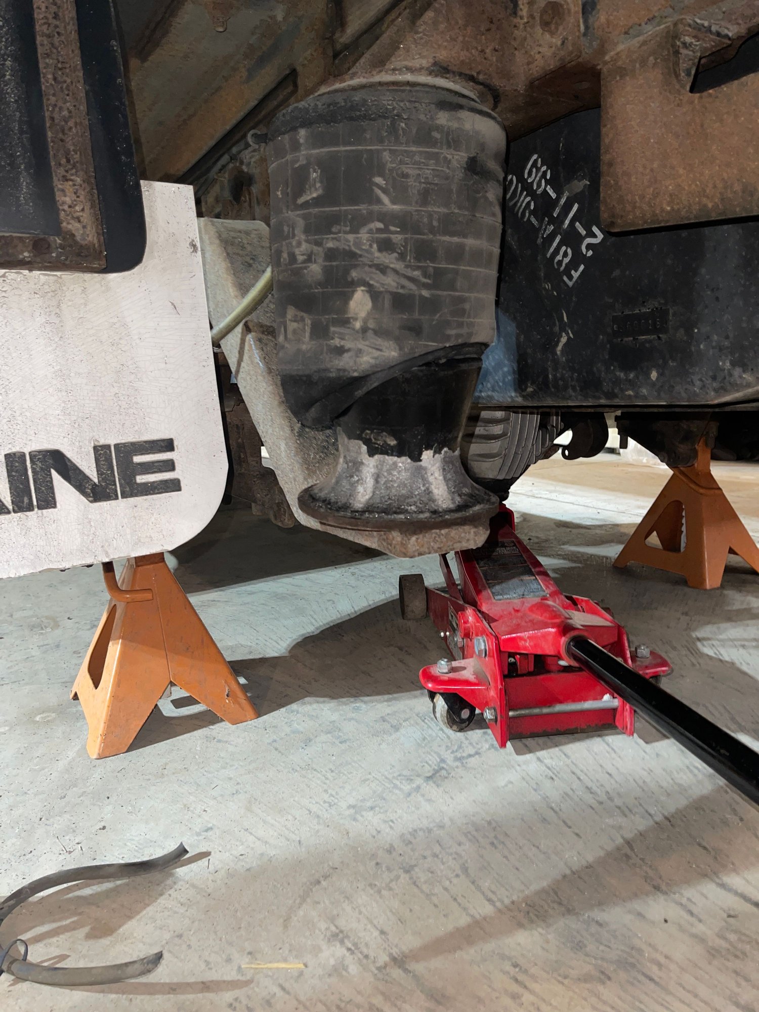

Originally Posted by Enoch sweiger
Hi, I’m new here so glad I found this thread… I have a 1999 f450 Fontaine package truck and I’d like to know if my truck has a recall.. I called ford and they said it didn’t but after seeing this I didn’t know I could contact Fontaine.. do you have a number for them or how did you contact them because I can’t find a number… I’d really appreciate any help.. thx in advance
This is how it sits currently… I’ve owned it about 8 months and replaced the rear air springs and put the flatbed on..
Before.
Before.
Before replacing the bags and painted the frame
Before.
Before.
ance
Hi, you seem like the guy to talk to about the Fontaine’s lol - How do I contact Fontaine because I have a 1999 f450 and I’d love to know what suspension package I have on mine.. and if there is any recall’s I’ve owned the truck about 8 months and replaced the rear air springs and put a flatbed on it..
Before.
Before.
Before.
After.
After.
Could you tell me what rear shocks you put on this truck?
Thanks
