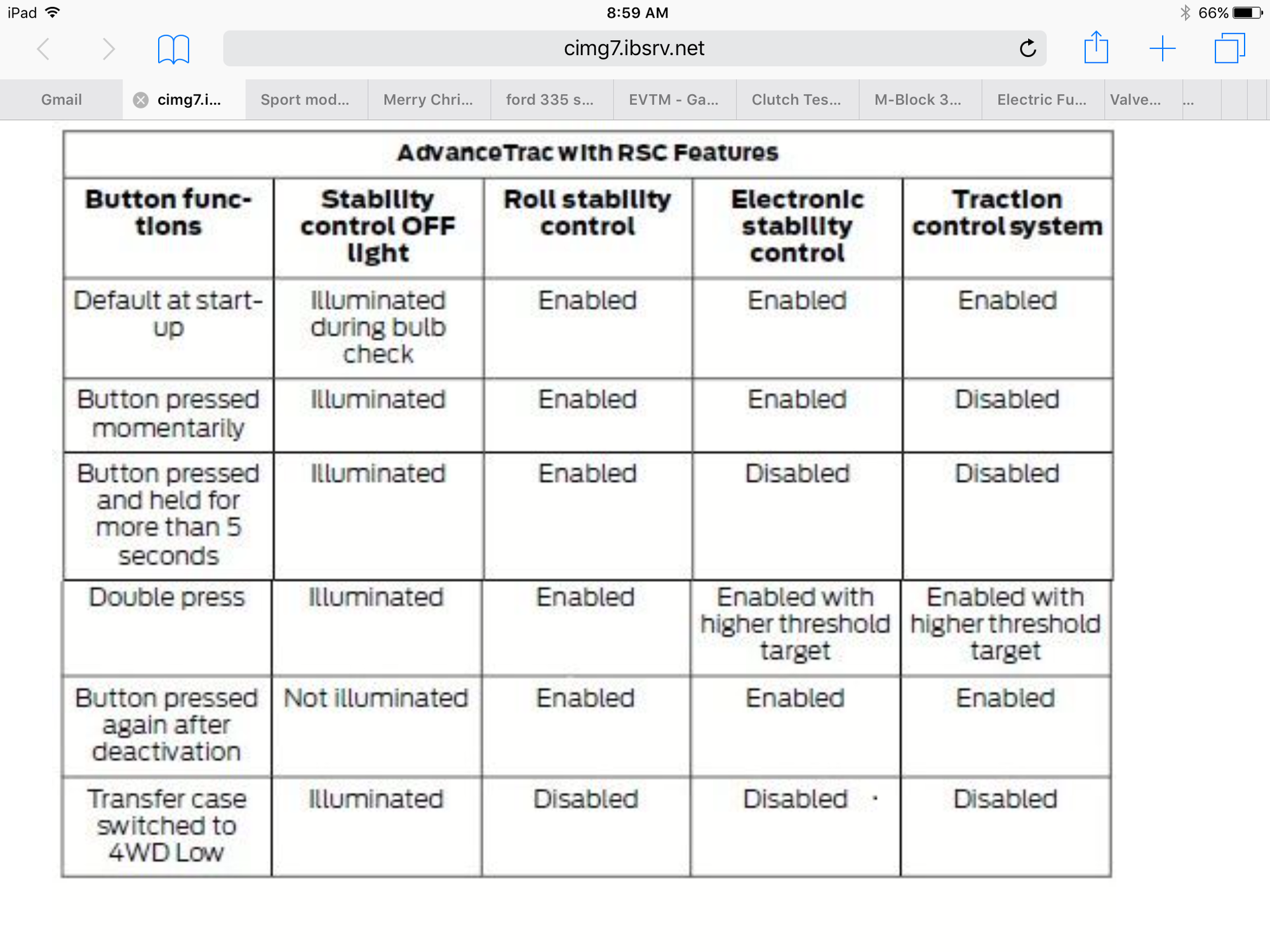

I'm not sure why VFRCanada deleted his post, but here's what it contained as I think it helps my understanding of what happens:

Yes, this is what I seen in vfr's post as well, if everything else fails, rtfm!

I deleted it because the chart didn't show up but I guess it did. I also posted this.
Electronic Stability Control
The system enhances your vehicle’s ability
to prevent skids or lateral slides by
applying brakes to one or more of the
wheels individually and, if necessary,
reducing engine power.
Roll Stability Control
to prevent rollovers by detecting your
vehicle’s roll motion and the rate at which
it changes by applying the brakes to one
or more wheels individually.
Traction Control
to maintain traction of the wheels by
detecting and controlling wheel spin.

So according to the chart press and hold does more than double press.
