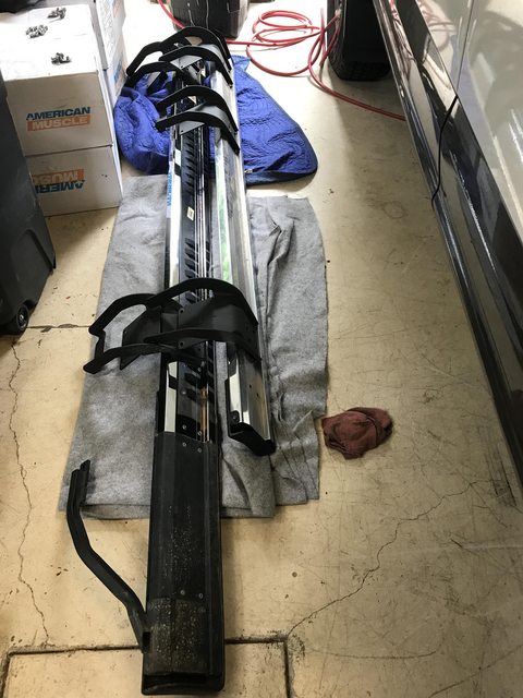

I have not done this, but I did just swap the regular 6" chrome steps on my KR to the extended 6" chrome steps. Here is a picture of the two steps side-by-side.
Attachment 284828
Note the extension support bracket, this will need to be modified to work with the F150 brackets. Does the F150 come with an extended step? If so, that bracket may be available; otherwise, you are looking at a cut/re-weld solution.
