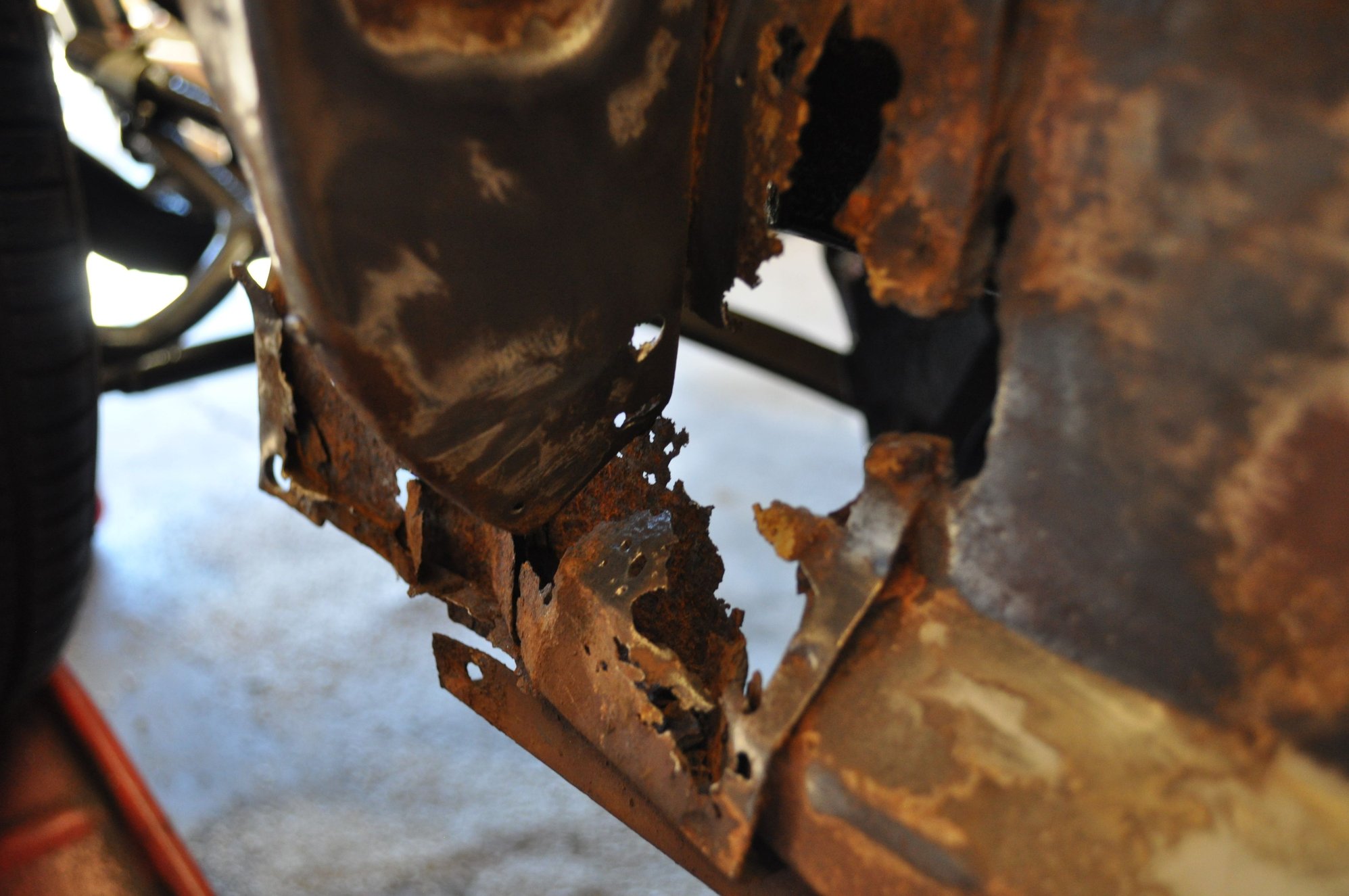

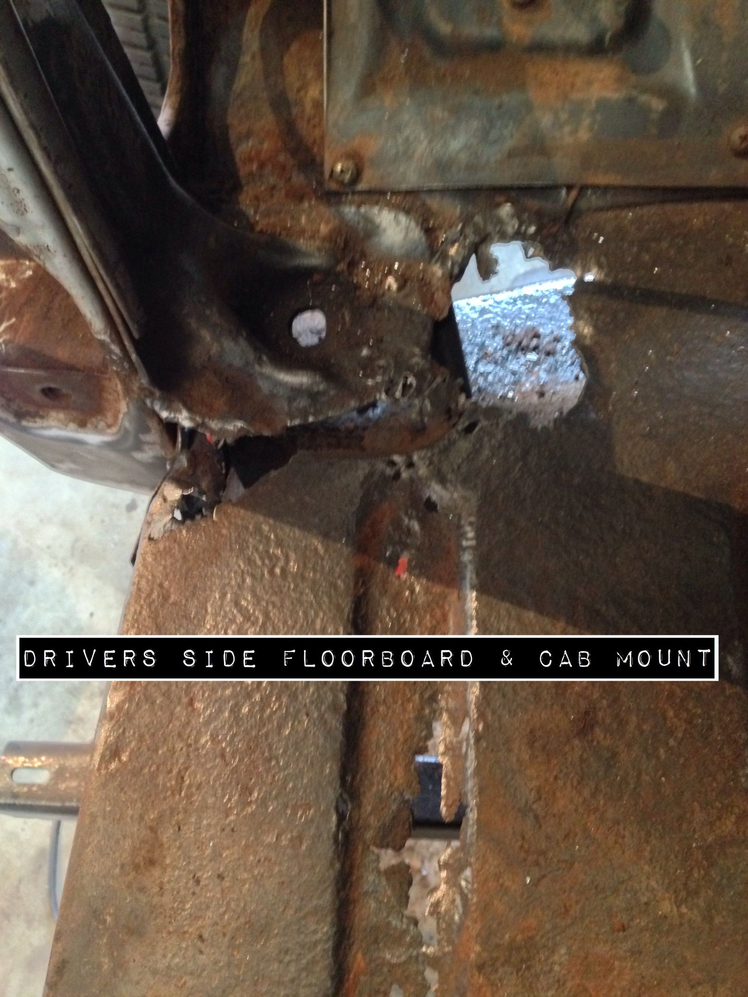

Got a question for those that have gone before. The drivers front of my cab is in pretty rough shape.
I bought a drivers side floor patch and a new rocker Panel. My question is do I install the floor first or the rocker?

I thought that repairing the cab on my 54 was beyond me...but thanks to help and encouragement from people here I was able to do it all myself. Here are links to 2 of my albums that have progress pics. Other than the patch panels the only other piece of equipment I bought is a gas Mig. I started with the Floor, then cab corners/door posts and finally rocker.

I do have a question did you lap the floor over the rockers?
Old Nov 6, 2016 | 08:45 AM
Indybeer's Avatar
Indybeer
Joined: May 2010
Posts: 1,125
Likes: 191
From: Wharton, PA
Yes I did. When I put the floor in I left it longer than needed till I got the rocker installed. I alternated weld tack holes in the floor panel and rocker, then welded the seam. Since I plan on putting a floor covering on it anyways it will not show. May not be real pretty welds, but they work.

I'm not sure if I'm going to have it sandblasted before I install the patches or not.[/QUOTE]
I had the cab blasted before replacing metal just to get rid of the thin stuff and see how far i had to replace but i would not do any other areas until you patch it because sometimes you destroy the only pattern you have to go by. You can do this metal repair I taught my sons and we had no idea how to even start. There are some great metal fabricators here to help you along.
