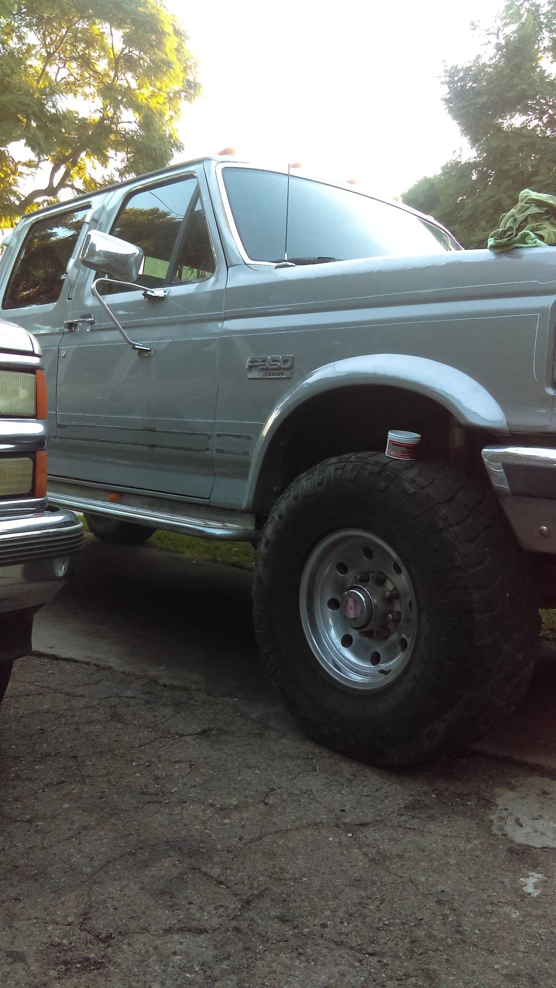

Hi there guys I bought a 1989 f350 4X4 just for the Dana 60 . Plan on putting it on my 85 f250. This might sound stupid but could I put the ttb in the f350 just so I can move it? It's a really nice truck 460 with c6 . It has a blown head gasket. I'm debating whether I should just keep it or just get the d60 and part it out. I honestly don't have space for it. 1989 F350 crew cab long bed 4x4 Laraiat Roll A Long Package

you are exactly right. Old man told me he didn't want to bother fixing it, that's why he sold it cheap just to get rid of it. I figured it was a perfect opportunity to get the D60 I always wanted. Yes I could fix it and flip it. But the question is could I find another d60 for cheap They are hard to find and are expensive.
