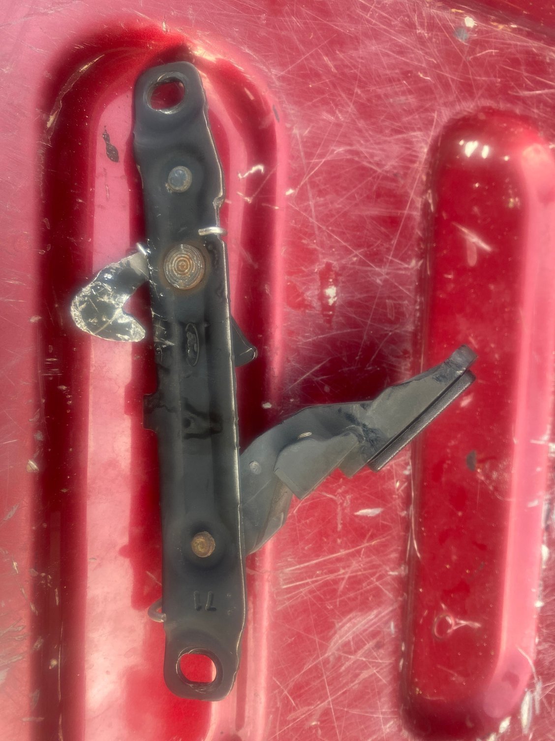

Posts: 1
Step assembly latch
I am looking for the step assembly latch. Mine is bent and prevents the step ladder from fully closing. Has anyone seen a replacement part for this? Thanks in advance!
