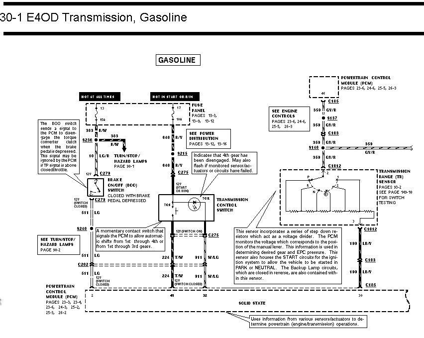

Originally Posted by Stickman'sF150
The neutral safety switch, or MLPS, prevents starting unless the shift lever is in park or neutral. It has no effect on transmission operation at all.
The Manual Lever Position Sensor (MLPS) used on the E4OD has a large influence on transmission operation. The computer relies on the MLPS feedback for the desired gear and EPC pressure calculations.
Read the MLPS operation theory in this diagram.
A common symptom of a failing MLPS is false neutraling while driving down the road. I doubt it is the root cause of the OP's issue but I wanted to point out your statement is not 100% correct.

rla2005, thanks for that correction. Adding this to the list of things I've learned from this forum, and saving the diagram. I thought the MLPS was a simple Neutral Safety/Backup Light switch.
