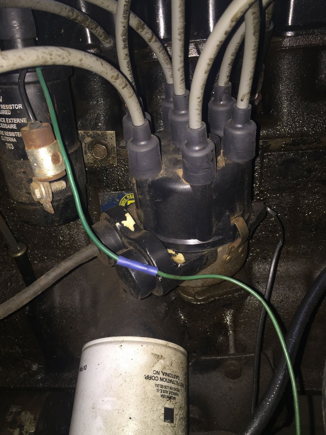

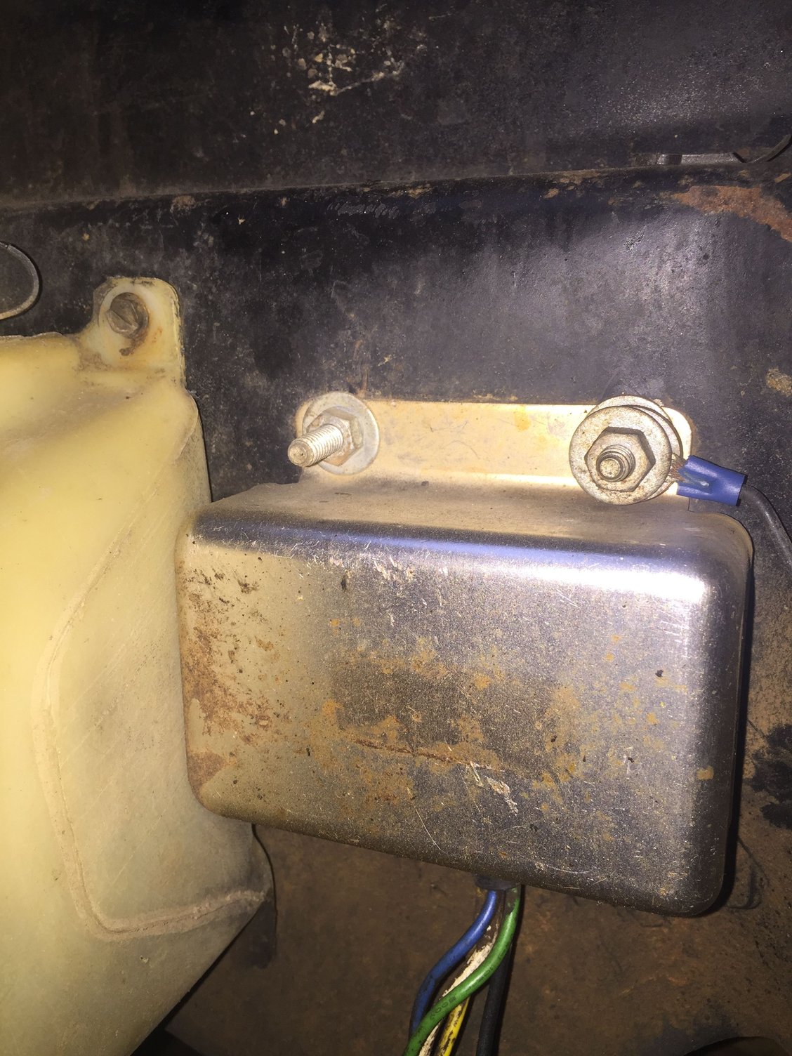

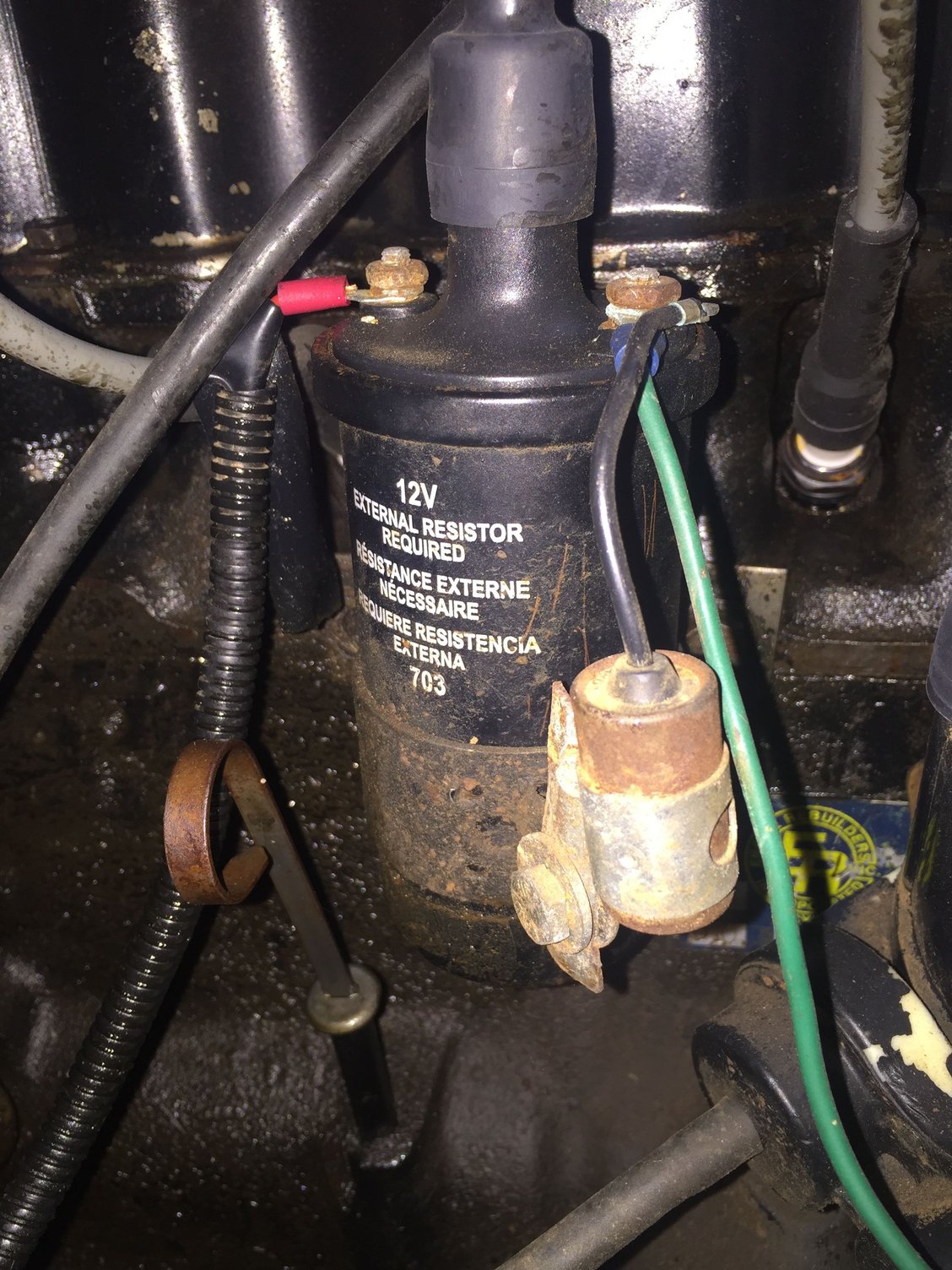

OK, you know how sometimes your memory just doesn't match up to reality? Well, this is one of those cases. The dizzy, module, and coil are definitely not very new. I think the new-ish plug wires tricked my brain. So this is what I have:
Dizzy:
Coil:
Control Module:

Wow you need to clean all the corrosion & rust from all the wire end terminals, O better yet cut them out and replace them all. An or buy a new coil as it looks pretty old just for a starting place.

In that case I won't tell you to try removing that radio noise suppressor condenser off the coil.
No, please don't tell me that.
I am aware that there is a possibility I am throwing out a baby with the bathwater, but it seems like a risk worth taking in this case.
