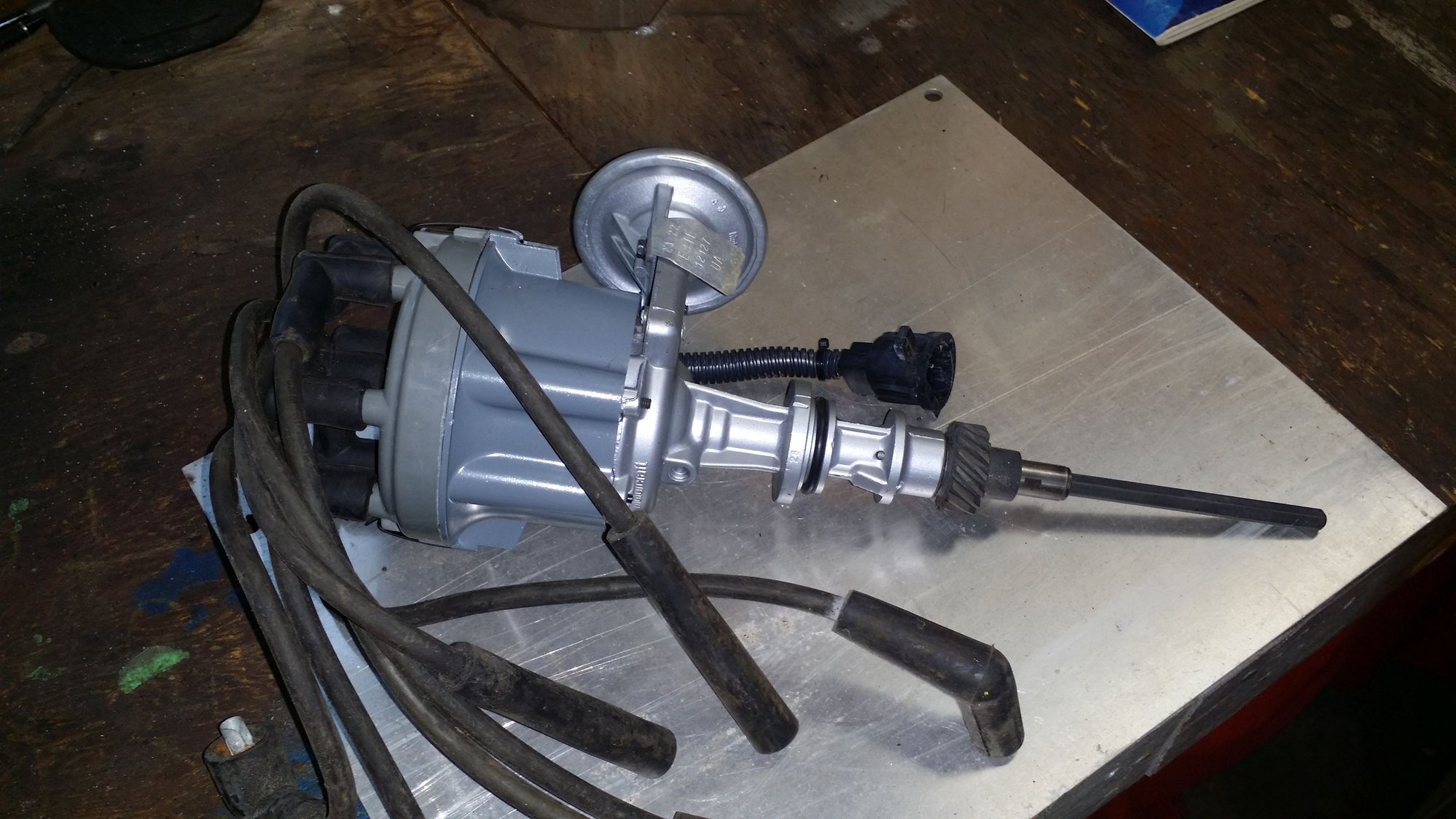

It may be a rebuild. Some pics of the dist would help
And a lot of the replacement parts now come from China and some can be of questionable quality to say the least..
Here is the stock Prestolite dist for your application
