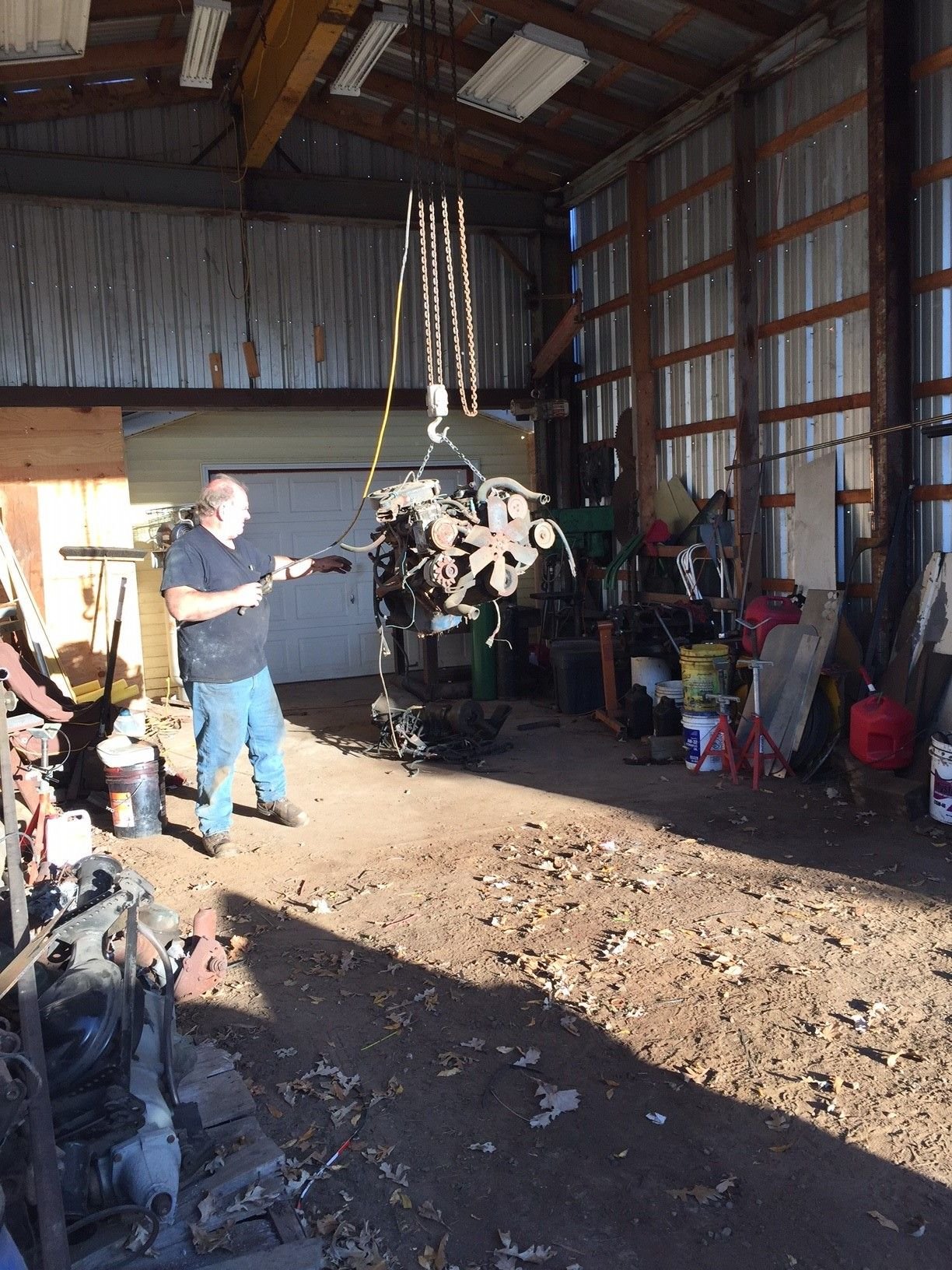

So I picked up this mid 80's model 300 6 engine on Saturday. This engine came out of a running truck and has good compression. the plan is to swap this engine for the the current one in my 75 and possibly rebuild it once its out. I am in the process of removing all of the smog BS and the AC compressor. I currently have one bolt behind the fan pulley I need to get to in order to remove the AC compressor shelf. I have removed the 4 bolts holding the fan on and neither the fan or pulley are coming off.
can someone tell me the proper procedure for removing the fan and pulley before I start applying force?
