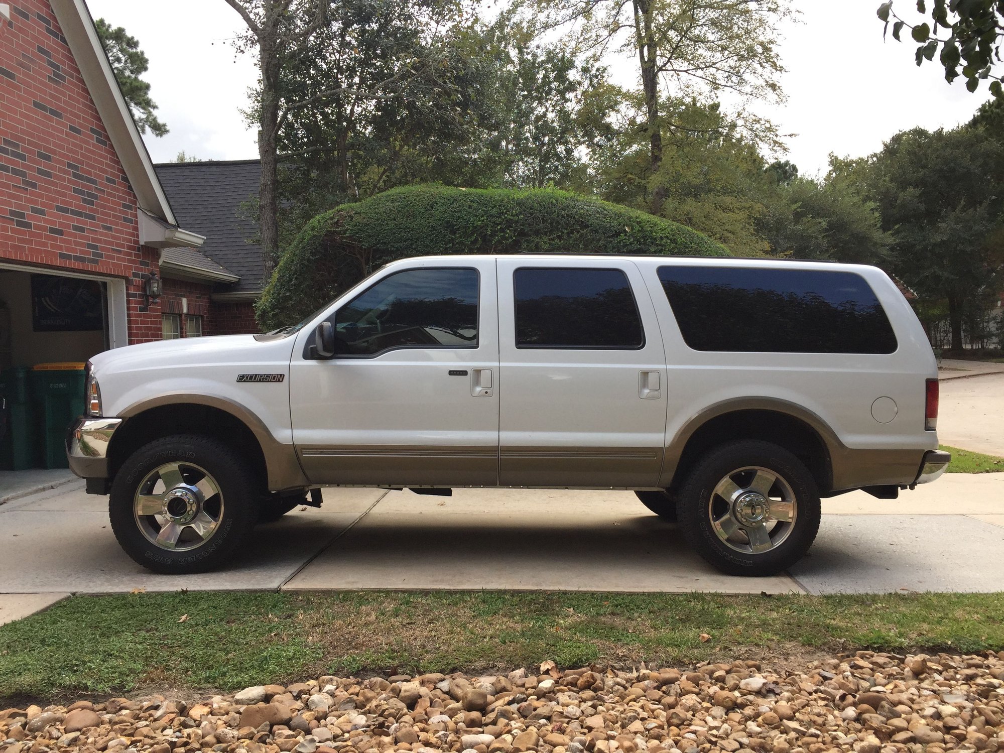

Here she is. This is my second Excursion I've owned. I had a 2000 4X2 5.4L years ago. My brother still has it. I missed having one and glad to be back in the driver seat of one.
It does it every time. Regardless of temperature it starts and goes right to 2k and then slowly goes down to normal idle rpms.
