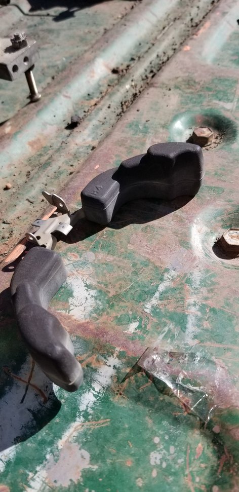

Originally Posted by AK FORD GUY
If you are not in a hurry, I think I have a complete Motorcraft 4350 carb that is yours for free. It should fin in a flat rate box. I am at work till Saturday night and could mail it out on Monday. It was from my 76 F250 w/ a 460.
If it has the parts you need, it's yours.
any chance he didnt grab that 4350 and you have a float available?
