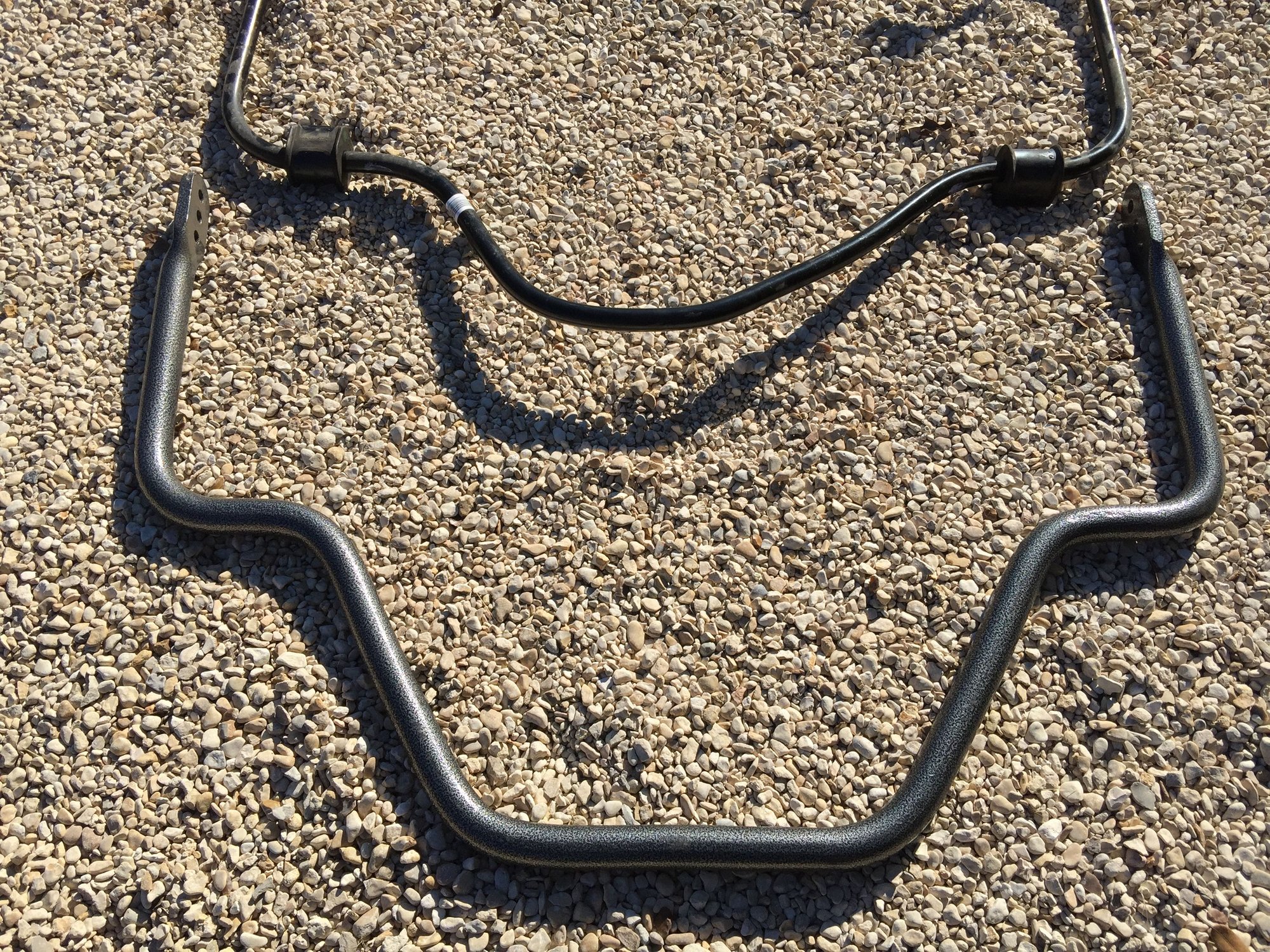

I am going to guess that the sway bar is the same other than mounting points or possibly the bends.
Here is the OEM swaybar vs Hellwig Big Wig

WOW, thats a huge difference! I have air bags on my current super duty. They do the job but I'm thinking they add to the side to side sway that you feel when a tractor trailer passes you on the interstate. Before I had air bags I had a lighter camper and I used Timbrens to level it. The amount of sway from vehicles passing me was virtually nothing. I have a theory that because the Timbrens contact the axle, that extra contact point is reducing the amount the truck can move side to side. I think the only wiggle I can see when I tested it by pushing back and forth on the truck was the side to side movement in the sidewalls of the tires. So my theory is that the Timbrens, while not adjustable like the air bags, nor do they ride as good if the truck is only lightly loaded enough to just cause them to lightly touch the axle, that the Timbrens actually help reduce side to side sway more then air bags. On round track cars we used to run Track bars to control this. I'm hoping that the factory sway bar will control my body roll but if not, after seeing this picture it will be Big Wig here I come!
