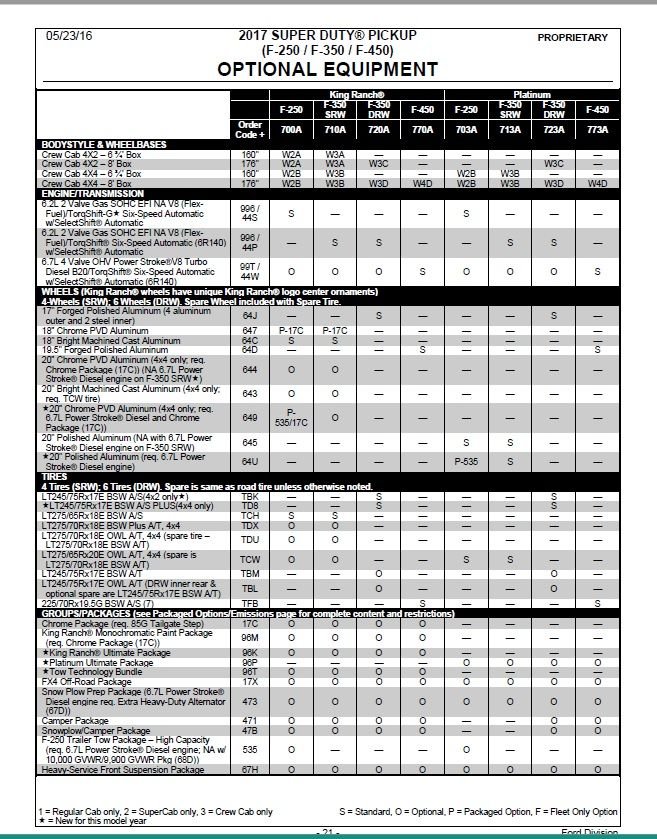

i’ve tried every way to build the truck and get camper package to appear. it will appear for a lariat build, but not a platinum
does anyone know for sure if a platinum can have the camper package
thanks

I see under the options Camper Package is N/A for 250 and 350 SRW...but option for 350 and 450 Duallys

Not available for F250 F350 Platinum. Here you go:

ok, great. thank you

The Platinum comes with 20" wheels and the camper package can't be selected on any trim level with 20" wheels. That's the conflict and the reason you can't get it on a Platinum.

Well technically....you can get it on a Platinum..but it's with configurations that don't have 20s...the 350 Dually and 450 Dually Platinum trim.
